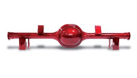

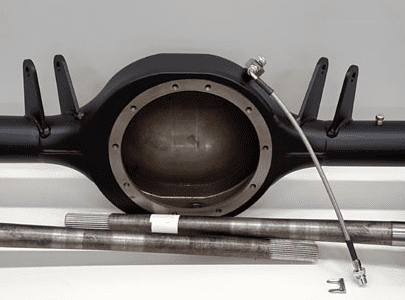

BTW you are going to get grief for using a Moser housing. They are designed for ford 9" 3rd members (center section) but they size the cutout to fit an 8 3/4"
If you are going to take the grief, might as well go with the stronger (firecracker lit :eek: ) ford 9"
Moser 9" made to fit an 8 3/4 center section (oval)
9" (Oval with a modified round)
Ford 9" (Oval)
Ford 9" (Oval)
8 3/4 (round)
8 3/4 (round)

Well that just plain sucks. Thought it was oval looking in the pic. Cannot locate 8.75 that owner is willing to ship.
