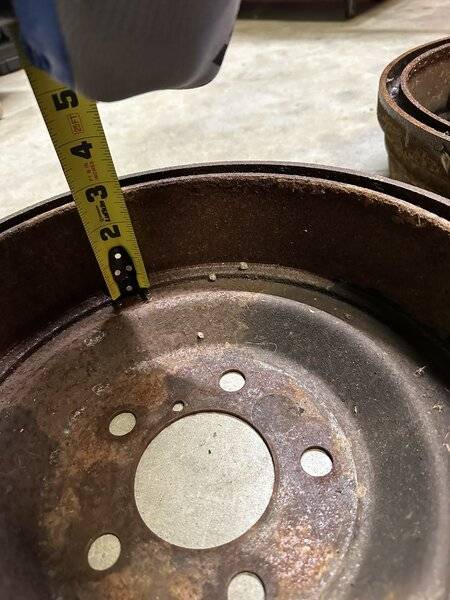

10x1.75 or 10x2.5?
A body or B,C,E Truck / Van?
I may have a set of 10" backing plates if your interested in pieces. Let me know and I'll verify the size for sure, I ended up going with 11".
If you don't mind, see what you have. If 10 inch will also need shoe spreader bar and e brake lever. Thanks for your response.
10x1.75 or 10x2.5?
10x2.5

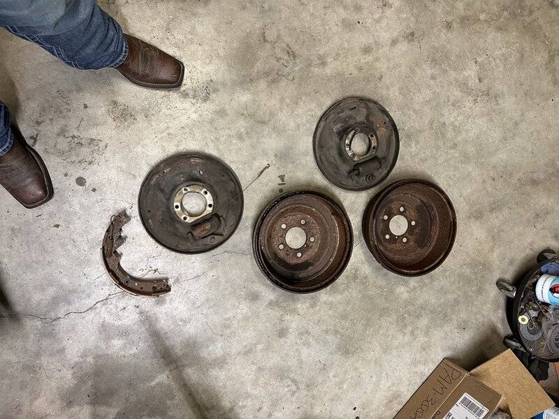

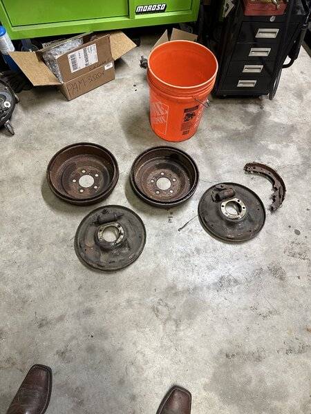

I have a set from a fury 2 I pulled awhile back
Probably because most of the 70's cars with 8 3/4 rears had 11" rear brakes, I am not sure I have seen one that didn't except for the original A body 8 3/4's that used special narrower brakes and drums
You said you may have a set of 11 inch earlier. Would that include the shoe spreader bar and e brake bar?
I don’t know what it’s worth make a offer on it
