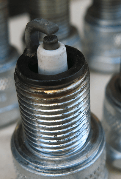

Those plugs look much better but still lots of grey and no color on the porcelain. What do they look like inside the shell?
Have you pulled the carb off to see if the reversion in the intake manifold has improved as a result of the header change?
The flash obscures some of the plug colouration
Here's a couple close ups that are better. I'll need to check if these were still RN9Y or the slightly hotter 12 which I have been trying out.
#3
What colours appear to the naked eye?
Edit: What ignition are you using?

Something you can try to do if you have access to Avgas you can run it on that as it has a lower point at which it vaporizes and so if you see an improvement then you know that's what you need to work on.
Or you can change the cam or the carb. The carbs easier to change and I would either try a 600 with straight boosters or get the 650 boosters changed. My preference would be the 600 as the it would increase the vaporization more so than the 650. Main bodies are cheap so you can use everything else. Its funny how on a running engine reversion can make its way all the way to the underside of the air cleaner. If the incoming charge isn't sufficiently vaporized in the intake runner then there's very little to oppose the exhaust making its way up. Do you have a smaller intake manifold you can use?
Like I said earlier advancing the cam will build more cylinder pressure which is most probably what you need.
Also some other things to think about. What voltage does your ignition unit see while its running? Make sure its at least 13.8v
What's the resistance of the plugs you use. If they are 0 resistance then check them and make sure they measure 0.5 ohms at most otherwise they are no good for what you're trying to do.
Same with the leads check to make sure they are all good and have similar resistances.
Grab a spark tester as they are cheap and see what every spark plug gets
Lots of cheap stuff to do to improve what you have.
