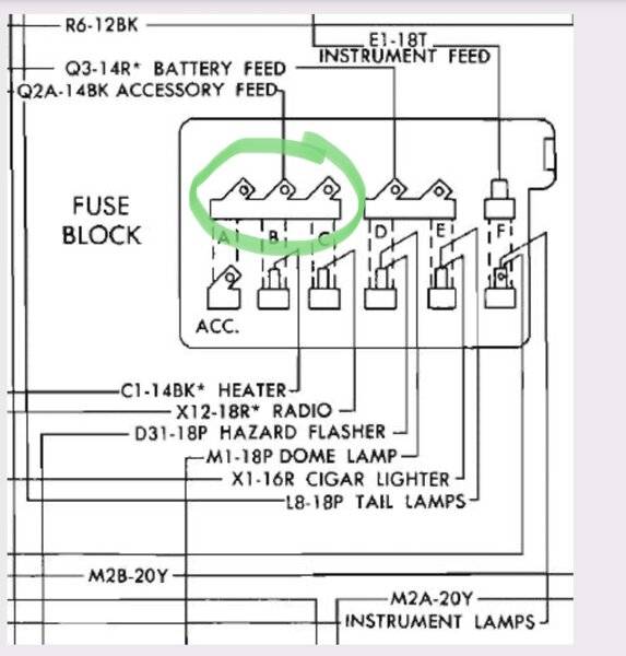

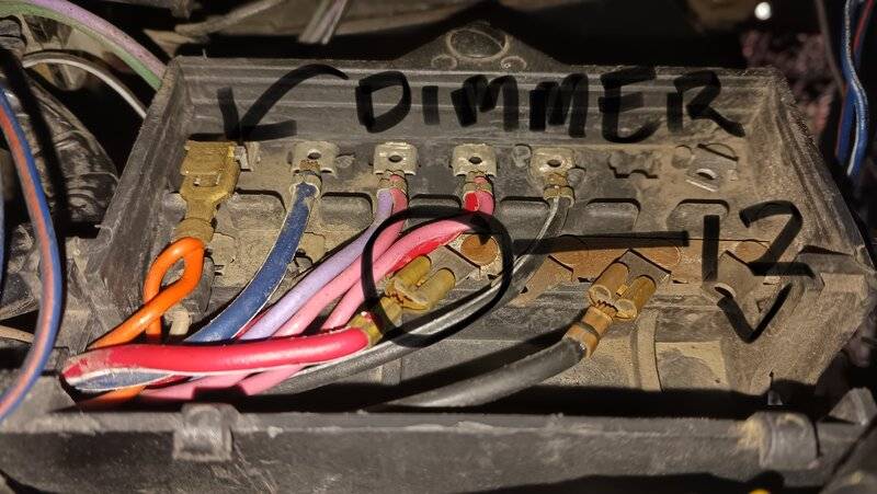

Hi folks,
Installing an aftermarket tach, 73 Duster.
I have my ground done and my green wire to negative coil. Can I use the following from my fuse panel for the 12 volt switched and the dimmer / / /instrument light?
The only "switched" in the fuse panel is ACC. This means if you are sitting listening to the radio, etc, the tach will be live. You CAN use that. Yes on the dimmer. Orange wiring coming off the INST fuse in the fuse panel.

The wire that now feeds your HEI is the same wire ( most likely) but I agree you can use the output from the 3 ACC fuses. If you have an empty space you can get the connector and run a dedicated run to the tach maybe a 5 amp fuse and 18 awg wire.
But as noted by 67dart273 the tach will be live in run AND in ACC
I have the ballast bypassed. Running HEI. I just finished taping/tubing everything up nice and pretty and don’t really want to take it all apart… yet.
Since you had to run the ignition trigger into the tach, you could have run a (fused) wire off the coil + stud to power the tach
IIRC that's how Chrysler powered the tach on some years/models/.

I don't want to detrail this thread further since the OP has much newer model. But yes we agree power was tapped for the tach from the switched accessory fuses.
