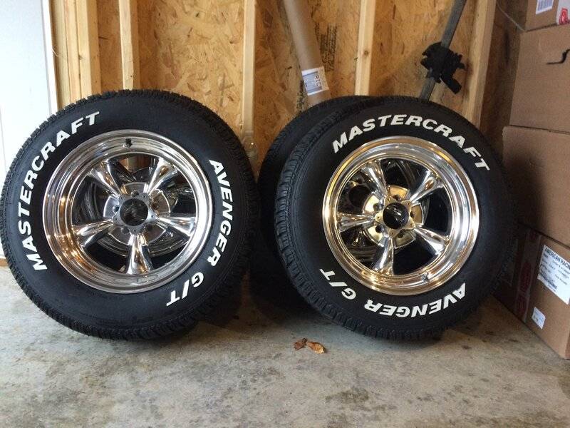

I run 215/65R15 Mastercraft Avenger GT's on all four corners. They are mounted on 15x7s. I have no complaints. They drive and handle well. I think they look just as good as the BFG's. I guess if I had a complaint it would be that the specific size I run is getting harder to find.
Those are pretty sharp looking. Always nice to see other Mopar supporters in VA (Portsmouth here).
Those look great and the wheels are sharp too.
