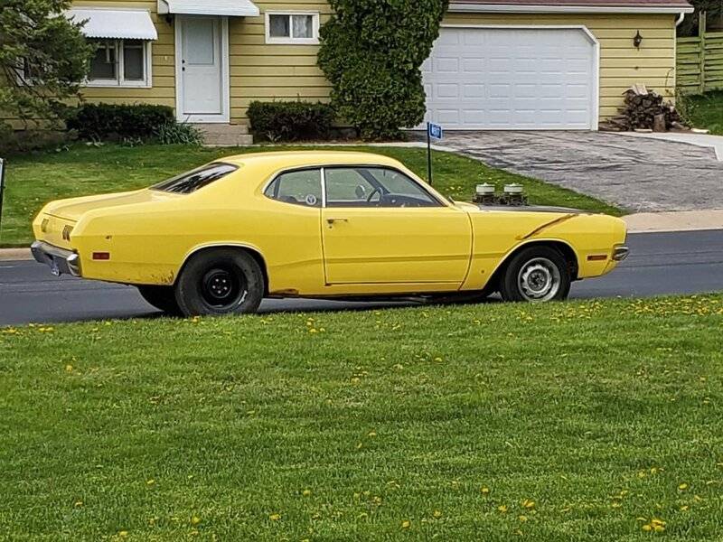

I need to wrap up my Dart so I can burn them up soon, as they are 3 years old and don’t like them to reach 4-5 years old.
But they still look incredible, and would hardly spin after warmed up powering the Challenger to its best times.

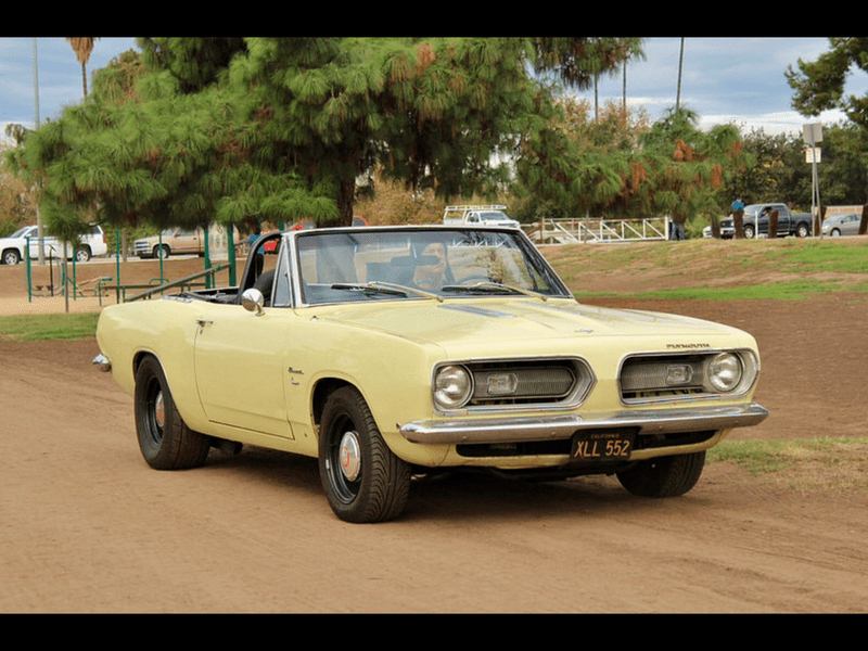

I just picked up a set of 225/60-15's for the front of my '68 Barracuda. They are V-rated with a 525 something treadwear rating. I'm having them put on and the car aligned on Friday. Cost was less that $200 delivered. Made in Taiwan, so from a modern factory.

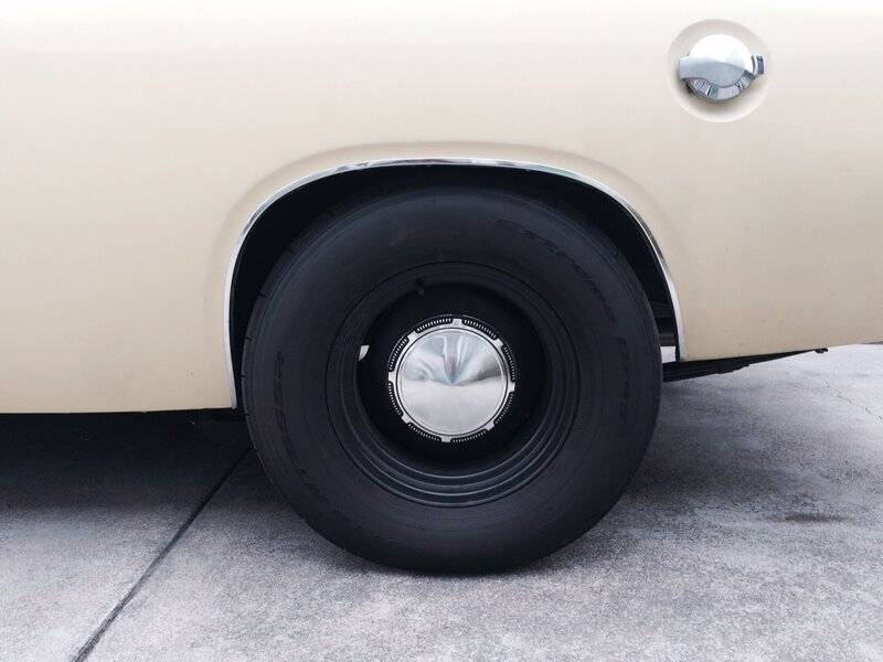

I run 265/60-15 Nitto's on the back. They make the car safe to drive on the street and work very well in the rain. One does have to be aware it is a wide tire at freeway speeds in the rain, but they are rated at 186mph.
What brand did you go with, and are you having any clearance issues with the rears? The fish in your avatar looks like it may be lowered.
I grabbed a pair of Nankang SP-9's with a 560AA UTOG, V-rated(149 mph). Walmart seems to have the lowest price on them.
The rears never rub. It used to have a 1 inch lowering block, but I've since removed it. I'm running a pair of passenger side 3200 lbs SS springs, rear sway bar and Koni's.
I do run a set of properly adjusted slapper bars to keep the front spring segment from bending on launch, as the car weighs in at 3700 lbs without me in it. It also has just over 500 ft lbs of torque at the rear wheels. Standard A-body 8 3/4 rear end from Dr Diff, and 8 inch rear rims.
I did roll the rear fender lip and trimmed the lower 8 inches of my front fenders due to running adjustable strut rods, which can pull the lower control arm forward to gain caster. Mine has around 4.5 positive caster even with the rear sitting about an inch above the 28 inch tall rear tires. The lower picture show the previous 215/60-15's on the wider than stock front rims. As mentioned, I bumped up to the next size of 225/60-15.

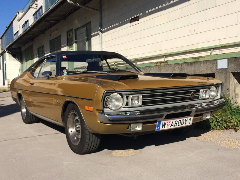

Nobody has mentioned the ones I am running on my Demon (same as Dad has on his Barracuda). 275/60-15 Firestone Firehawk Indy 500. I have these going on all 4 corners of a 1968 Charger stock car clone now too. They have a great look, work great, and are inexpensive.
I wanted to use these or the Uniroyal Tiger Paws but just couldn’t get the right sizes in a matching set.
