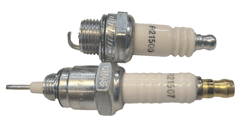

I wonder what the old mechs thought, way way back when, when the first metric spark plugs showed up. Some of the old Buicks? and Chevs? I think used 10mm threads. We used to have some in the basement for some reason. The flame sensor (flame rectification) for the old Lennox pulse furnaces was a 10mm plug body with an extended electrode. Here's a sensor along with the ignitor which is nothing more than a spark plug
