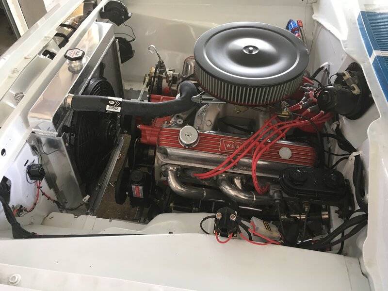

I run a 15/16 master and 2.75 calipers on two cars, both stop fine. I use an adjustable prop valve in the line going to the rear drums and bypass the factory distribution block. Both cars are manual brake, and the pedal feels nice

I don’t have a residual valve on either car. Got all my parts from Napa except the prop valve from summit.

Do you mean the long spring and the 2 steel pieces that go in the cups?
I don’t remember the application, but they are aluminum with plastic reservoir... also have two bolt mounting.
The one I used was a MP 4 bolt.
