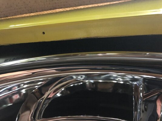

My son is looking at 18” Ridler 606’s for his swinger. Do you know the backspacing on these? Also could you go with a little fatter rear tire?
The back space is 4.5” per the Ridler website.
I don’t believe I could go any larger on the tire since it’s pretty close to the fenders now.
Thanks for the information. We were hoping for 245 in the front and 255 in the rear. I may have to stick with the 235’s unless they offer some additional backspacing options which I don’t think they do.
According to the Ridler website they only offer the 18x8's with 4.5" backspacing unfortunately.
