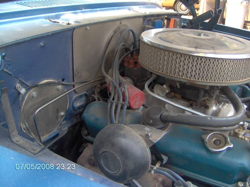

62 with 360 Magnum Schumacher mounts maybe it is possible to fit -62 K member on -61 ?
