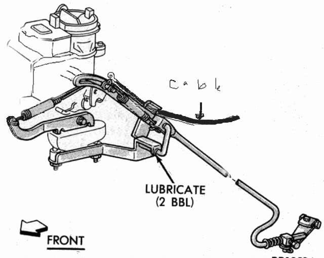

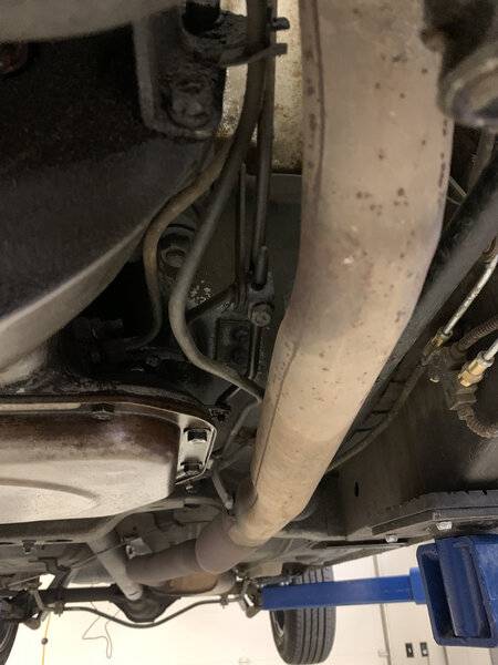

Here are a couple of pictures of my '66 Dart GT linkage , note the '66 used a cable to operate the throttle , the rest of the linkage is what you should have on your '64 .
