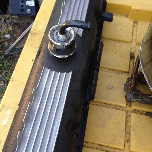

The front one sounds like the breather/oil cap and the rear should have the PCV valve there. Sounds like it's missing. Can you post a picture?
Here is a pic of my Commando calve cover with the chrome cap and PCV valve. Your slant would have a painted cap with the Valve installed.

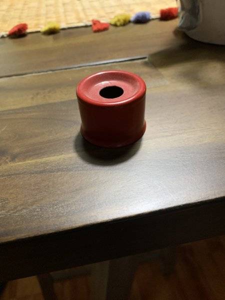

I bet they would just laugh at you. If you can’t find the cap locally, I have this one that was powder coated by Leanna. I could probably scare up the rest of the parts to make a complete unit.
