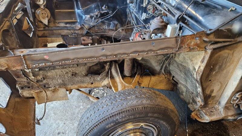

The inner fender wasn't in best shape. I fabricated a new flare to weld in place.

Finally the welding took place this morning. Some primer and paint and the fender could be mounted with some adjustments.
