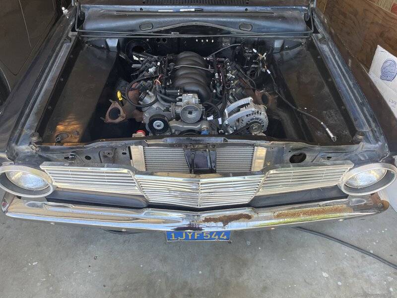

Would you show us more ? Was it a straight fit ? Did you had to change the Crossmember? What tranny do you use ? Pics from iunderneath ? Questions over questions and yes..... gate me but i like the idea
I have another thread on here from a while ago that goes into more detail, but in short:
I'm running a Tremec tr3550 five speed, and I was able to reuse the factory crossmember with some modification to move the mounting holes further forward. I used a mid-sump oil pan from Sikky, and I relocated the oil filter to near the front of the K member. Rear end is an 8 3/4 that was in the car when I bought it, so I just had to have a driveshaft made once I got the new trans in. I used a hydraulic throwout bearing, so I mounted a clutch master to the firewall, reinforced it with a plate, and was able to reuse the factory clutch pedal. I did have to make a new pushrod that I mounted below the factory location on the pedal.
Other things to note:
Tanks INC efi tank/in-tank pump
Battery had to go in the trunk
22"x16" radiator that would fit further forward into the core support to make room for electric fan
LS6 intake (truck intake won't clear the hood)
Holley terminator x and harness (poorly wired through the blower-motor hole)
