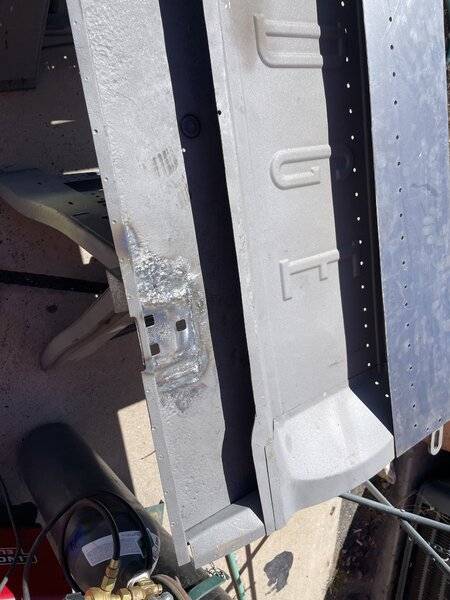

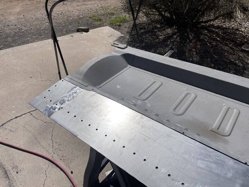

Sorry I still don’t like doing this stuff but the donut dolly made it a bit easier. Sixteen gauge is a handfull. Hinge braces reinforced and welded stiff. I should have shot epoxy so I could weld it up and roll the lip tomorrow but it’s windy and I’m spent.

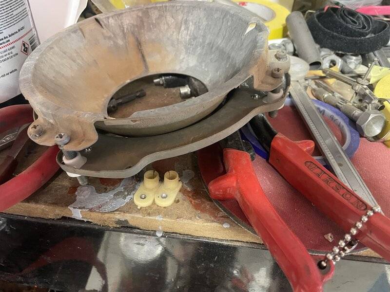

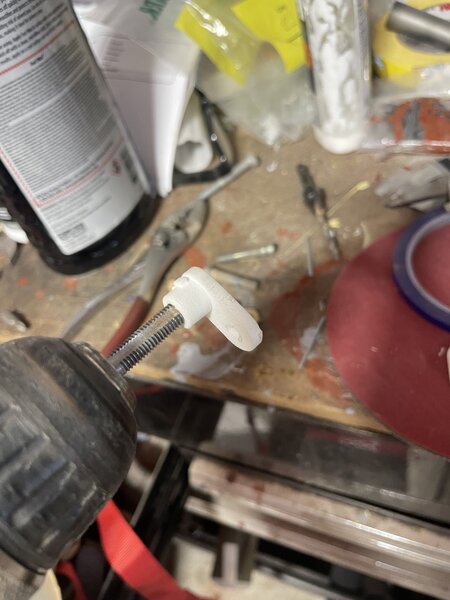

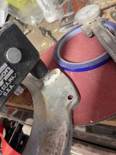

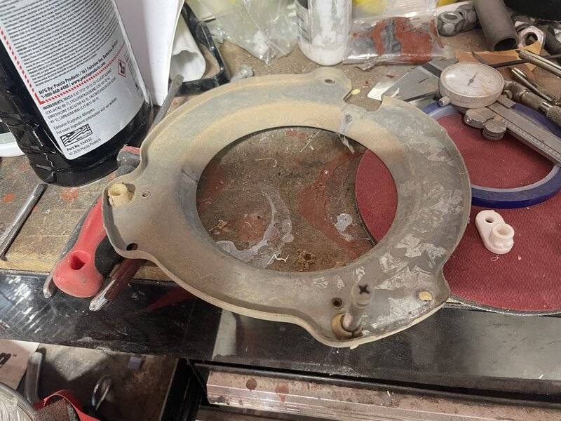

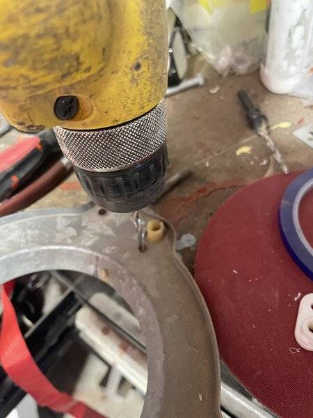

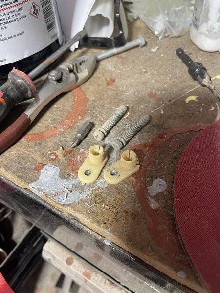

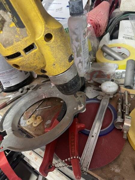

My headlight adjusters came in from Shapeways. Yep they are the same as a 1966 A-Body and fit perfectly. Make sure you run the tap in and out a dozen times and the screw in and out a dozen times to make sure the plastic is fully cut and the screws won’t bind but other than that took longer to pick up the tools and do the job. You can get these on my ShapeWay store. I don’t mark them up at all. The cost is what the unit cost is.

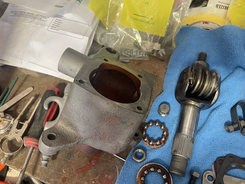

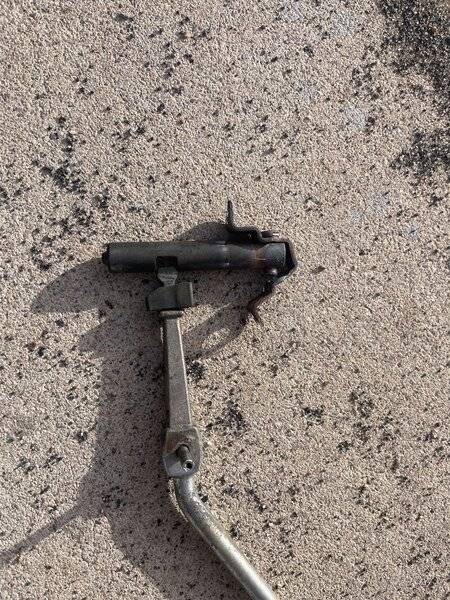

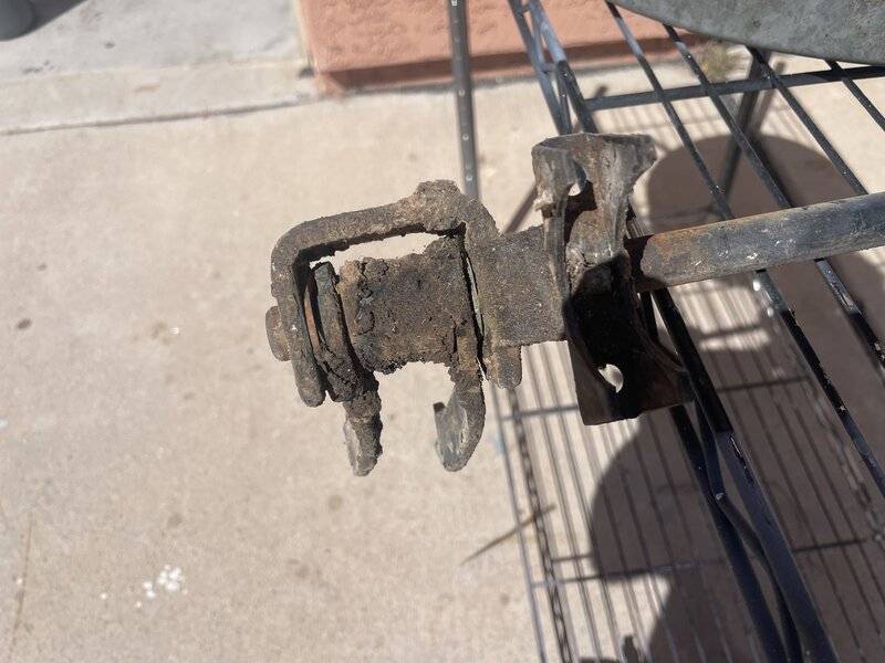

Since I can’t actually make any progress on anything else, and I have parts strung all over the place, waiting for a multitude of things to put them back together why not take something else apart! And of course it’s a search to find parts for these too. Called the@ normal Mopar steering gear places and nobody deals with truck boxes. I looked up part numbers for seals and I can’t find any new old stock so I have some from Grainger coming that are based on measurements. Fingers crossed. Everything else is cleaned up painted and restored. Just need the seals. Also need to either get a U-bolt clamp for an automatic or cut, the one off that has the three speed bracket. Anybody have the correct U-bolt clamp they part with? Interesting these boxes appear to be painted oxide red from the factory.
For the steering box, the Jeep Cherokee version has successfully been adapted to older A/B Body applications. If you're not a stickler for originality, maybe look there.
