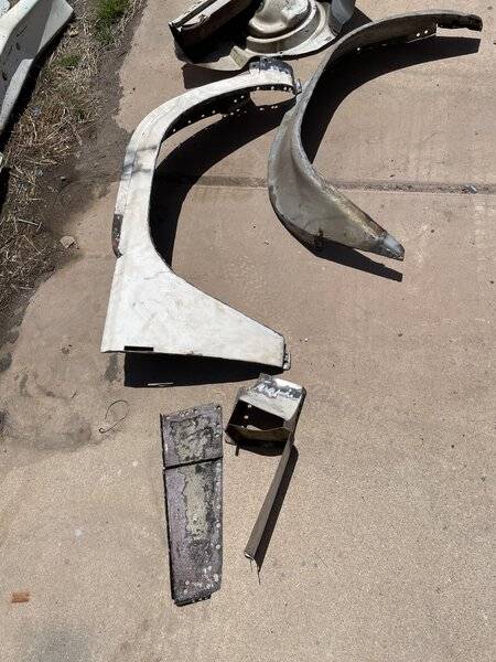

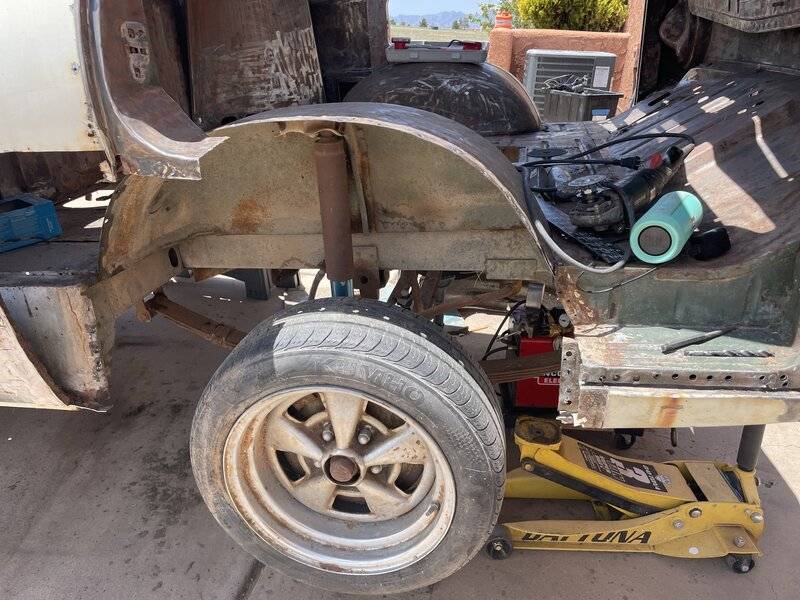

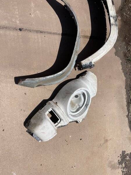

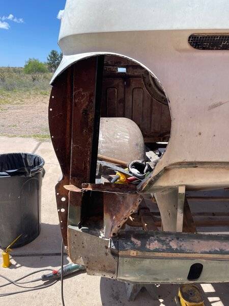

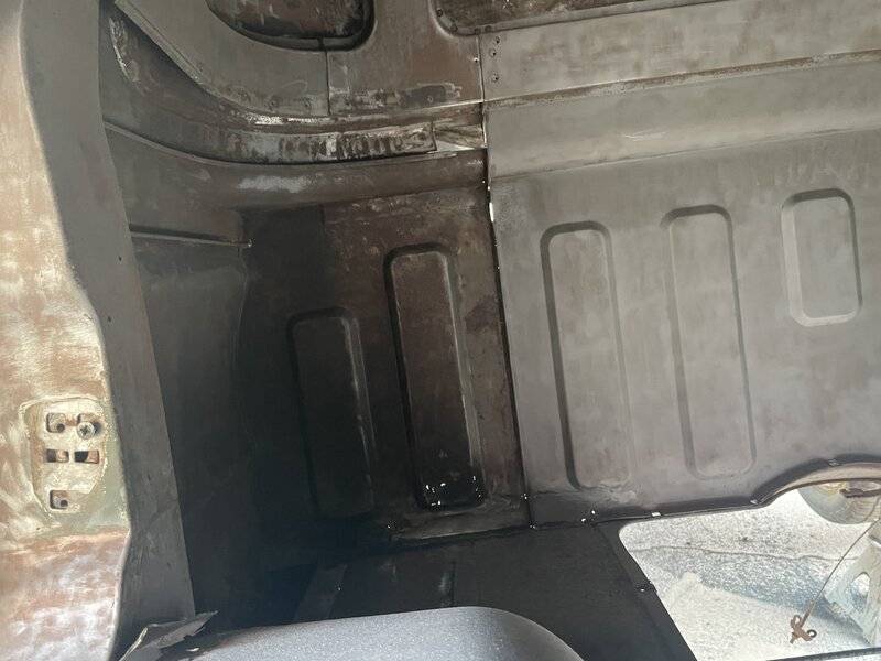

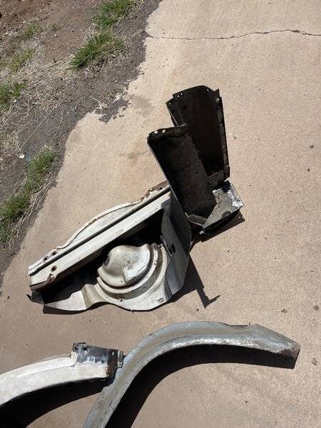

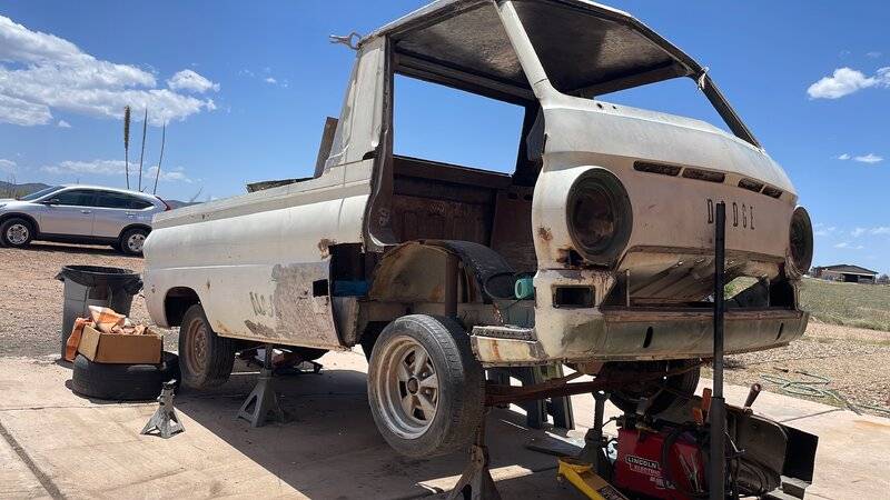

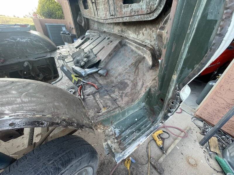

Committed now. Some Rusty and crumpled metal out. Floorboard wrinkles hammered out and almost flat now. Slowly contemplating what and where to cut and graft. The 80’s body work was top notch. That area around the lower hinge was like this then filled with filler.

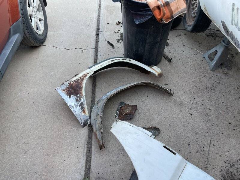

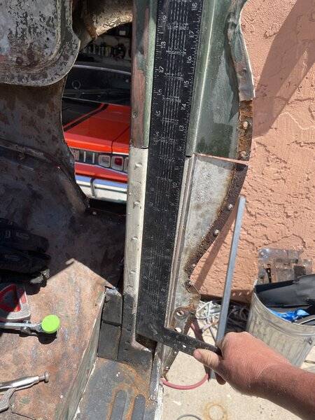

My conscience (I named mine Robert McCartney) said it’s better to separate the panels vs trying to graft on the entire corner. Patch panels separated from the step back ready to clean and mock up. Next comes the corner piece. Nice to be able to slowly pull it apart as a complete section you can roll to any position to understand how it was assembled.

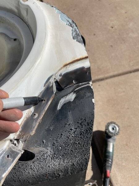

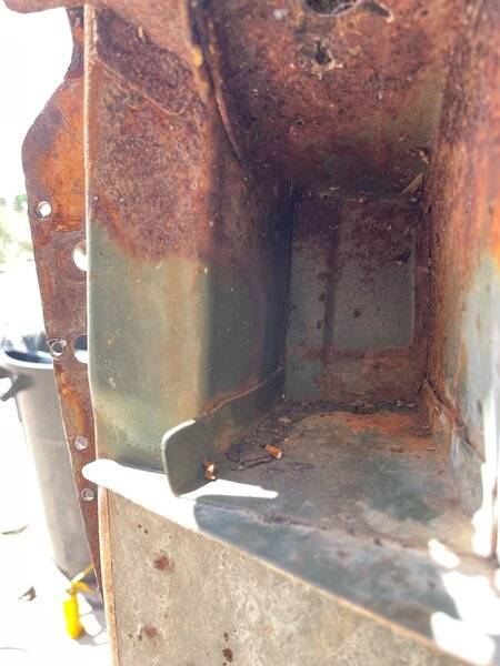

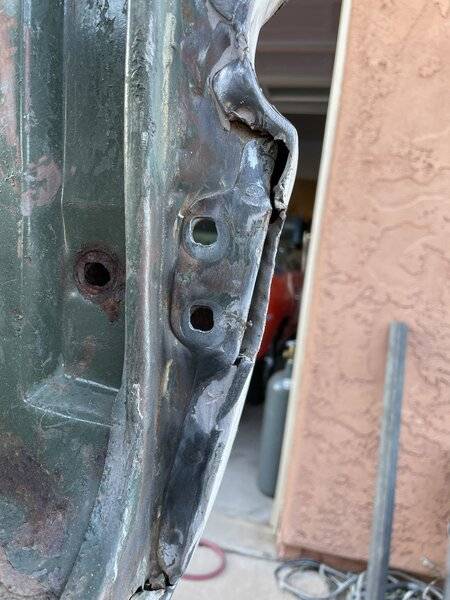

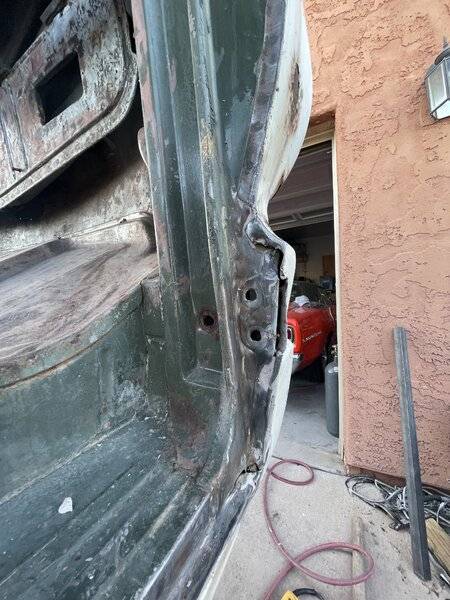

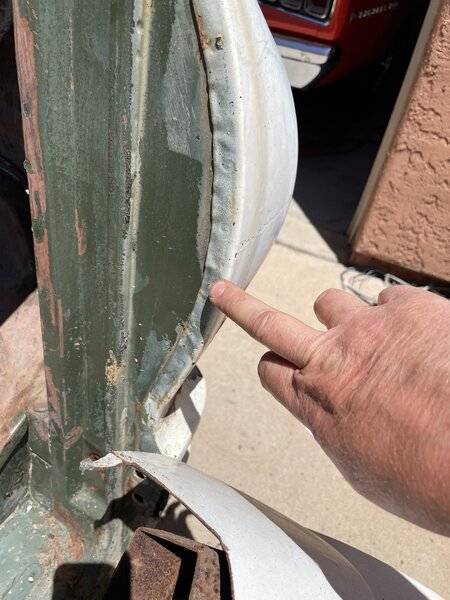

Day 3 of drilling spot welds is actually getting better as I am seeing the end... sort of... The door post is tweaked from that fender bender... guess since I have one I should replace it. Someone asked how I find the spot welds.. usually like this.
It was just that damn spray foam. Where the foam was and water got to it destroyed the metal.

Oh I grew up in central NY... I know what rust is! That is why I attacked this... it was worth saving even if it is a PIA.
Jim, What rust reformer or process do you use on those spots that you will not replace?

Media blast it and epoxy. Yea we are having weird monsoon like weather this week.

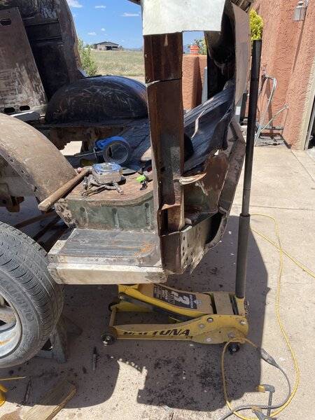

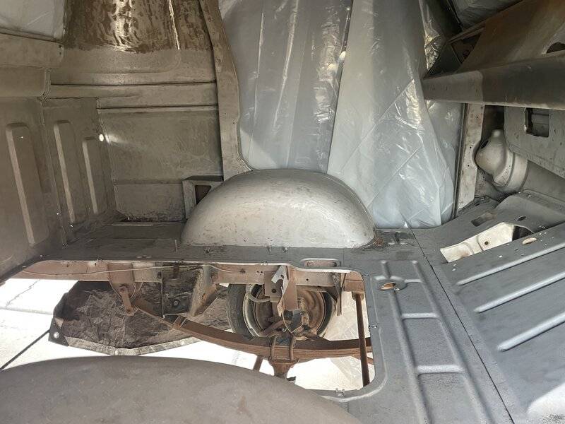

My conscience (Robert) is going to make this a quality job no how much work he makes me do. It does look so much better without the bow and wrinkles in the step area and door pillar. Need to trim the pillar joint a bit more to pull it up to get the correct hinge spacing and close up that gap. It is nice a straight now.

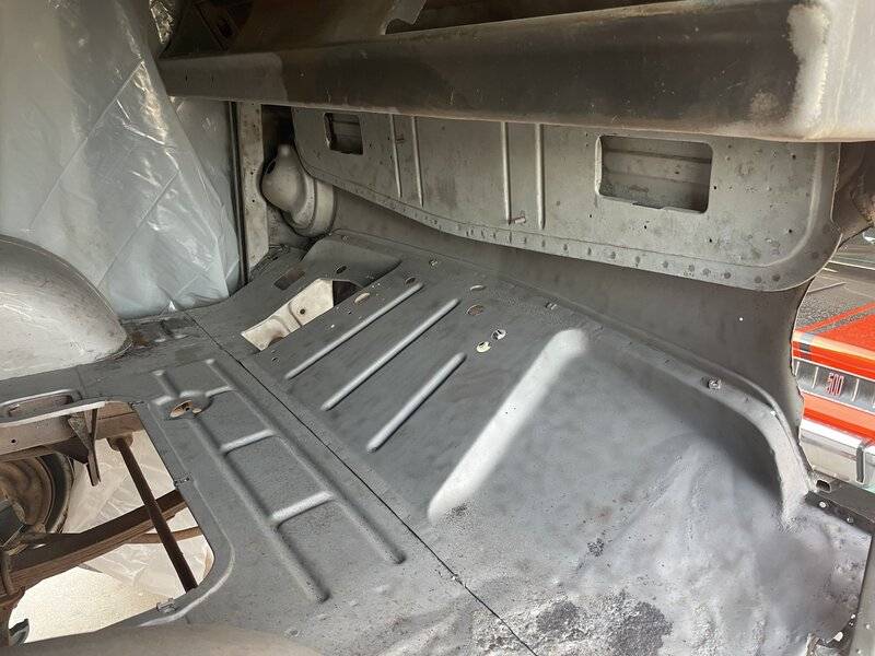

Why not back up 3 exciting days of drilling spot welds by blasting for 3 days? I had enough and it was looking like storms were rolling so I packed it in and covered it up. Tomorrow I should have the interior done and can finish up the welding. Amazing what a bit of high velocity coal slag, crushed glass and Starblast can do.

I use coal slag and Starblast. Both last a long time. So far I have about a bag and a half consumed. I doubt I will have more than $150 in materials when done. My time on the other hand…. My local place gets $100 per hour. I have about 12 hours in getting the interior of the cab done but there was a ton of black pits to get dig out. They take forever.
