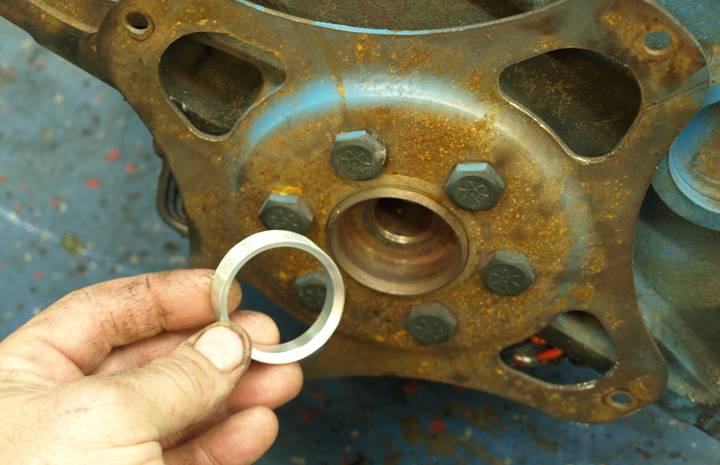

    Hi all, I’m about to drop a 360 into my 1966 Barracuda Formula S with the early 904.
    I keep reading that the crank snout of the 360 won’t fit the 904 correctly and cause problems. Despite searching I can’t find any recent reference to such a bushing. I will be using the B&M flexplaye with the cut away for balance and want to use my existing 904 convertor. Where do I look?

          Look at the photo I posted. The early Torqueflites and early crankshafts had a smaller size snout/ smaller bore. So when you mate an early TF to a 68? / later crankshaft you need either a special converter with large snout, or a bushing........which someone could make, actually, with a lathe

              It’s called an annular ring, and I believe Pat still sells them. Charlie S should have them also, or they can be made quick enough on a lathe.

                  It's not the converter attached holes, it's the crankshaft register diameter that the torque converter snout locates into. 65'

                    It will run off center and vibrate, eat the pump, spew fluid out the front, leave you stranded on the side of the road on a dark night only to be beset upon by highway robbers and antifa.

                        I cut a pipe, cut it horizontally and tapped it onto the snout...mic'd it and the crank register..and it was .025 smaller than it needed to be. Ran it. Also did that early on with a pc of fence post when I was in a pinch.

                          You wanted a source for the bushing. We gave you that.
                          You can't find any "recent" reference in "contemporary" media? A quick search of "convertor bushing" in the transmission forum turned up at least a half dozen references, some new, some old... old posts are just as valid as new, these things were built 50 years ago and they still work the same way. That's why a 50 year old FSM is essential to the hobby.
                          Now you poo poo the reason it's even needed- what's up? You do know how these fit together, right?
                          The convertor nose needs to be supported, on center, by the crank (that's why there's a nose on the convertor in the first place)- when you mix and match parts they need to be adapted to work together as originally designed.
                          If you don't believe me, go ahead and throw it together.
                          Then post for help diagnosing your mysterious "engine vibration".
                          Then ask why your B&M flexplate keeps cracking... and tore up the convertor... and pump...
                          Oldmanmopar is probably right, you should just use a later 904- better internals, no convertor snout issues; direct bolt-in to your '66; linkage swaps right on, uses the same driveshaft.
