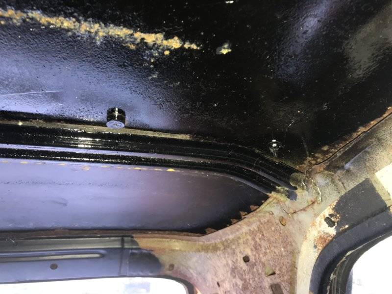

These are the nuts under the trim goes across roof. I’m not sure how to remove the side trim. Dustin

How many nuts are there, my shop manual is vague on this. How are those protective caps attached? Thanks for the picture and help....
i haven’t messed with the caps before but I’d imagine they would come apart upon removal. I’d estimate 6-8 but can count tonight. Dustin
Those little nuts are rubber, they just unscrew before you remove the fastener. Screws from the top. There is a few bolts and nuts.

The two trim clips that screw into the roof are the closest to the window. The other trim clips are plastic and just scree into the roof. The rubber pieces on the end of the screws are to protect occupants from injury from the sharp ends of the sheet metal screws.
But as others have stated, to access the nuts on the outward spring clips you must pull the headliner down. Plus, when you unscrew the plastic clips the rubber protective pieces fall off.
