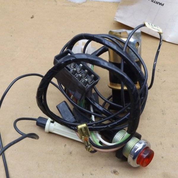

I think both were optional accessories. The rear air defroster hardware in the rear will be hard to find; the switch not as hard and the wiring harness can be duplicated.
The hazard harness was constructed with 2 connectors so that the 1 connector plugged into the turn signal harness and the other to the dash harness with a separate wire to the flasher. The other wire from the flasher goes to the fuse block. If you have the connectors, the correct terminals and switch, the harness could be duplicated. I had a NOS assembky. But ended up selling it i made one for a 65 Coronet i had and it worked perfectly. I have everything to duplicate that harness and if I ever got off my lazy butt, I could do it;it’s just a real low priority right now
The original hazard switches are a special oddball. They are 4 terminal, all open when off, all 4 connected when on. One terminal is incoming power from the hazard flasher, one terminal goes to right front, one to left front, and last one to brake light switch line running from brake switch into column turn switch.
You can duplicate that switch action with a common single pole switch and 3 rectifier diodes, say, 5-10A and at least 24V PIV
https://www.forabodiesonly.com/mopar/threads/n-o-s-rare-emergency-flasher-kit-1966-barracuda.454853/
browsing on here i just now found this. looks like the light is part of the flasher kit
Interesting. My 66 Barracuda has that light for the brake warning light. Was it an either/or option, or were there 2 lights if you got both brake warning and hazard lights? Or did they use the same light for both? My first 66 Barracuda that I bought in 1976 had hazards, but I can't remember if the light was dual purpose.

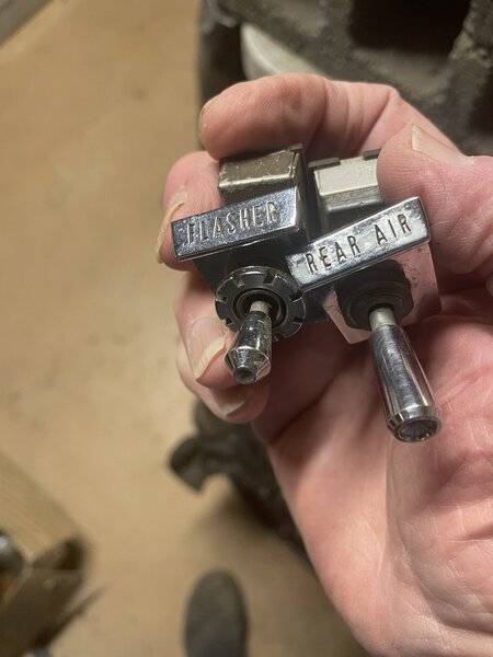

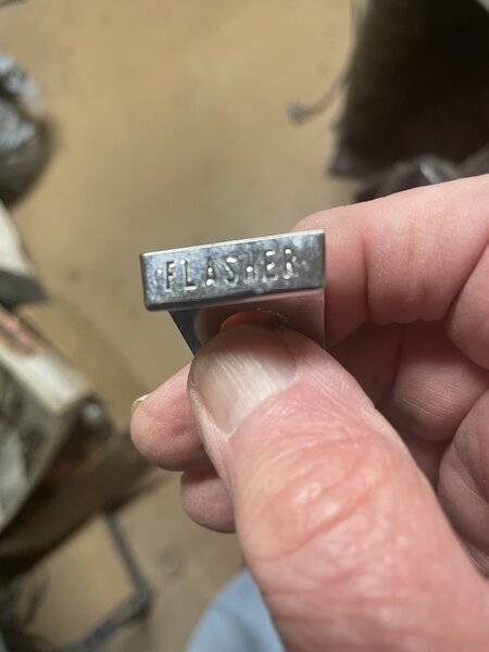

i found the instructions for the Mopar flasher kit and i clear describes installing the little red light and the toggle in these exact location as this Barracuda that i posted. Not that some other kit may want the same location, but to me this is the flasher kit on this car.
