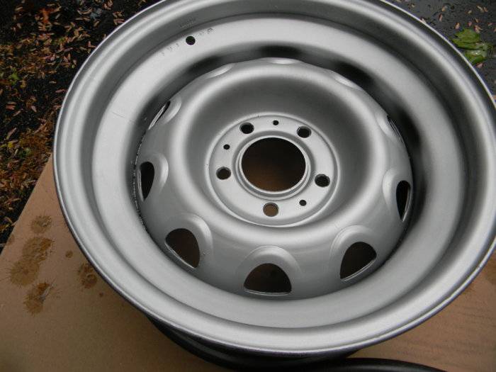

Thanks! I am unable to find 14" steelies wider than 5,5 inches, and as I’m planning on 245 rears that is a nogo. The rallies come up to 8" wide with SBP 5x4, so I’m thinking rallies painted black if the covers fit!

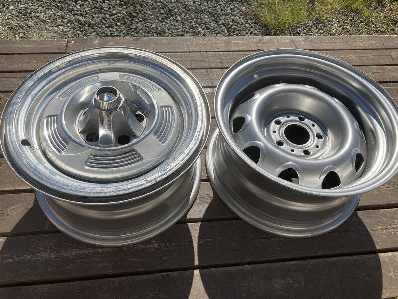

Thank you for your awesome feedback! I went ahead and ordered the Wheel Vintiques 61 series, 14"x7 BS 4.25. It was worth the LOOONG wait, because I think these will fit perfectly with my 235/60-14s in the rear. And I CAN CONFIRM, the 1964-66 sport wheel covers fit snug and perfectly on the Wheel Vintiques!
Now off to get the rims painted black, before mounting the wheels!

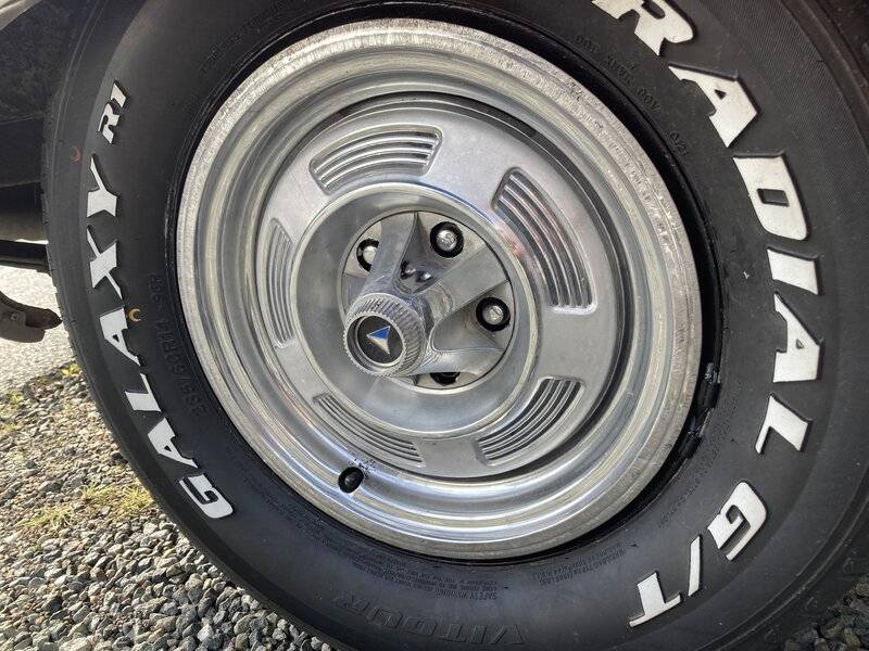

Here it is, finally mounted. 235/60-14 on 7" WheelVintiques. The bolt holes on the cover only match 98%, but that’s OK! The bolts are hidden well behind the covers on the 7" rim, they don’t protrude through the cover, as they do on the original 5,5" up front.
