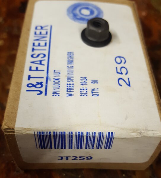

I believe these are the clips and nuts, have to bend the arm out to fit the trim size.
Iirc, I used these on my top trim, but I do not recall the ends being different.

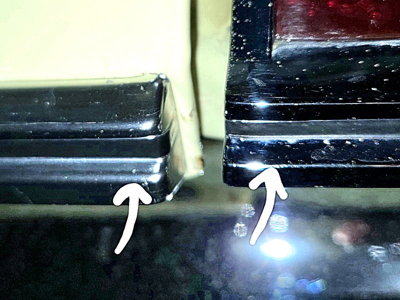

Once you notice the difference in the contour of the tail light top vs bottom, and the contour of the lower trim, you can't unsee it.
There's a noticeable bevel sloping down from the center of the trim, the back part, to the vertical face of the trim.
It is very pronounced on the tail light, and in turn very noticeable on the lower trim.
Also, upper/lower trim had black tape in the center, the black in the tail lights was painted.
Arrows show the 'bottom' of the lower bevel, roughly. Can also see the black tape wrapping around as opposed to the black paint on the tail light housing.
