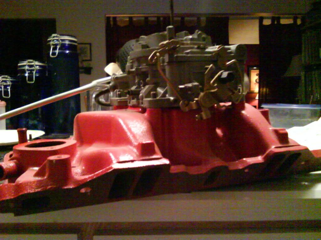

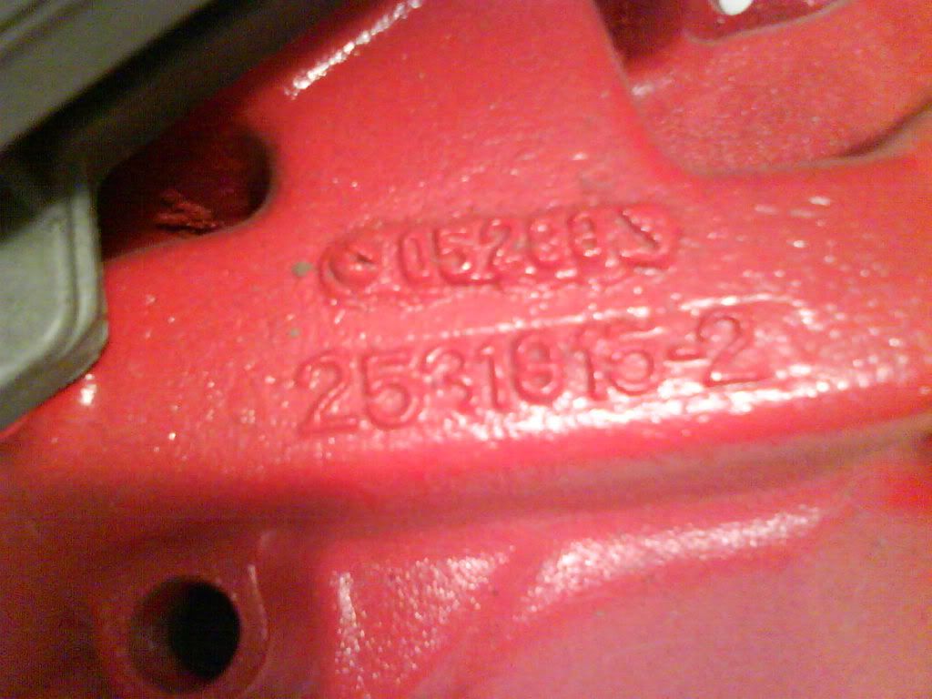

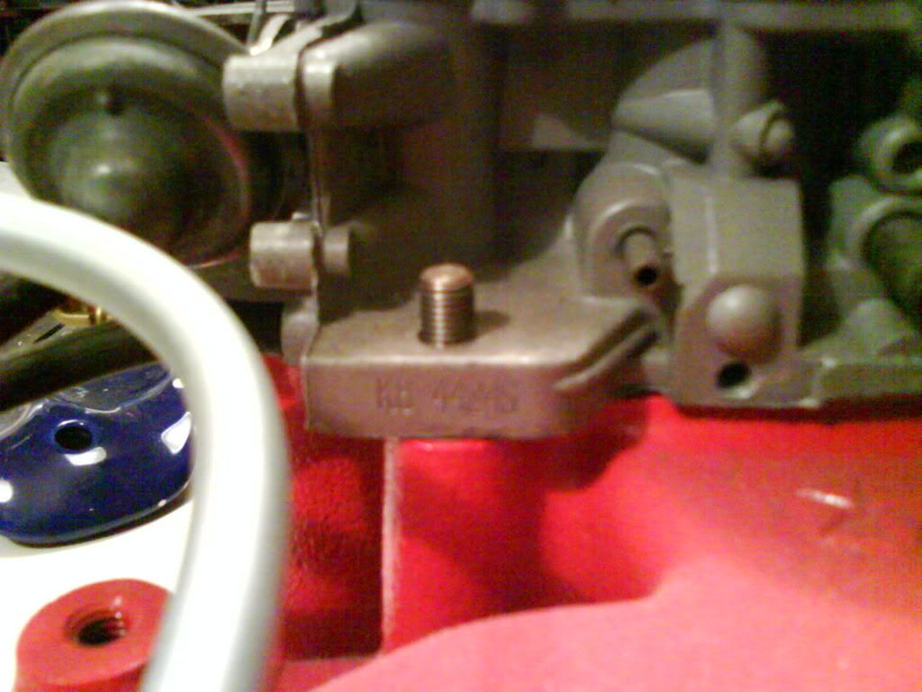

Factory 68, 340 intake set up. Bad phone pics.....
4424S, AVS (4 speed)
2531915 Intake
Should be forged pistons, Comp ratio should be 10.5, should be X heads.should be a 625 cfm carter,First year of the 340. 275 hp.
