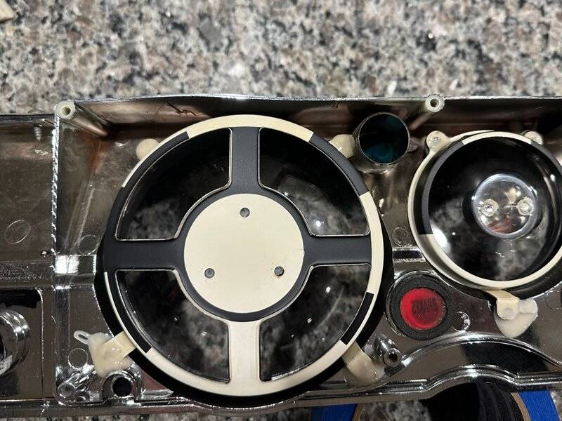

Thanks for the advice! I have the same gauge lenses to install, and found a few issues with the bezel in the form of broken guide pegs and some of the warning light lenses fell out as the hot melt adhesive holding them on peeled off. The guy who previously "restored" the dash used masking tape to hold them on and it caused further problems and I'd like to do a better job.

Also I've made a fair share of plastic repairs on my '85 AMC Grand? Wagoneer and the JB Weld 2 part bonding for the most part did not hold up under the stresses. Permatex was better but for the ABS components - disolving or using ABS cement for bonding has been the best. I have not (yet) experimented with heat but OMM's suggestion will be a part of that when I do.
