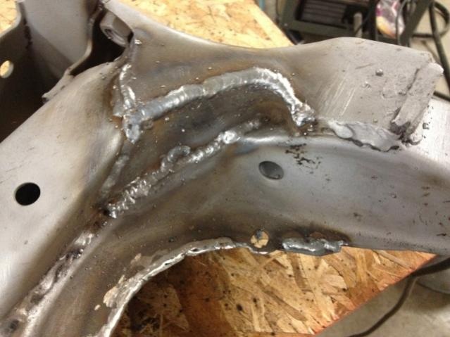

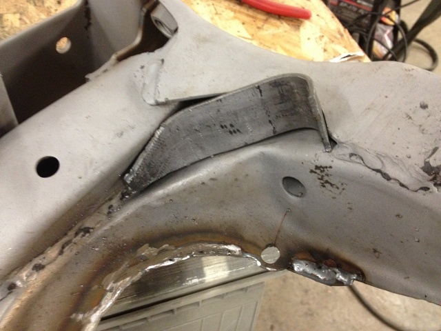

First you see the other area of the steering box being boxed with a metal piece partly cut to fit. I welded it partly, trimmed the upper overlap, then finished the welding.
The next pics are a u-bolt welded in to slots cut in the K, then a skid plated welded over top. I sliced the plate so it would bend, then welded over the slices.You can also see the edge seams are all welded over. My welds don't all look so great but its plenty strong. The black coating is POR 15. I used a pom pom on a long wire to get it inside. To me welding is one of the best parts of the project. Its just fun.
The idea for the tow hook is from another member (mad dart I think).
