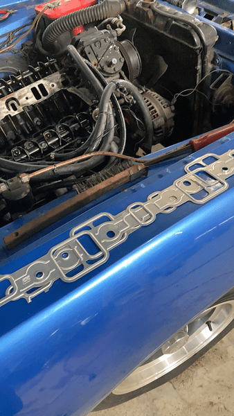

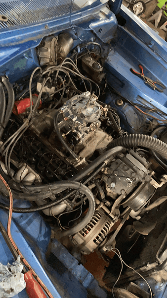

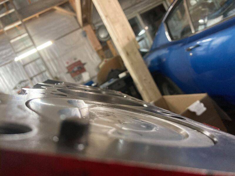

I picked up the intake manifold gasket today. They had the metal one, so I coated it with the "gasket tact" around the ports, put about 3/8" a bead of black silicone, and a small amount of RTV around the ports on the manifold. I then waited a about 10 minutes to get the bead tacky, then plopped on the intake manifold. It is all tightened down and gonna sit overnight to dry the RTV in place. My valve cover gaskets will be at the parts store in the AM, so I will put them on after work and fire it up.

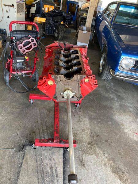

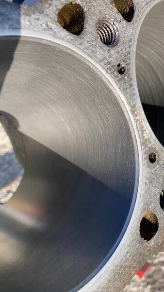

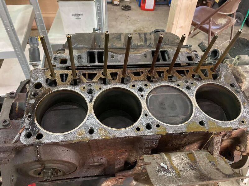

Tore into the new engine that I picked to build a stroker out of. I decided to use a 2001 5.9 Magnum that had just under 70,000 miles. I am using this block to minimize machining cost. I can use stock bore sized hypereutectic pistons, do a dingle ball hone, and build a budget stroker. There are no signs of bore wear on this engine at all. The engine is very clean inside and out. Thinking I will go with Indy MA-X heads with the blend job and 2.02 intake valve.
The "brown look" in the cross hatch is just the flash from my phone.

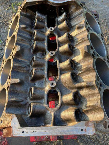

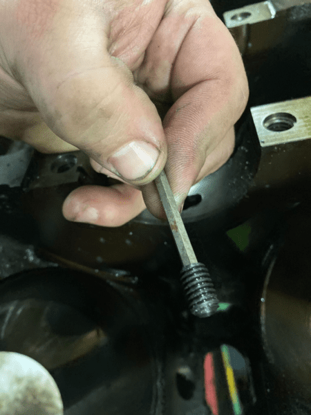

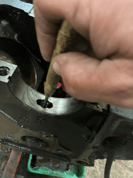

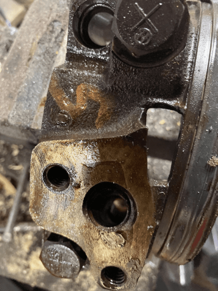

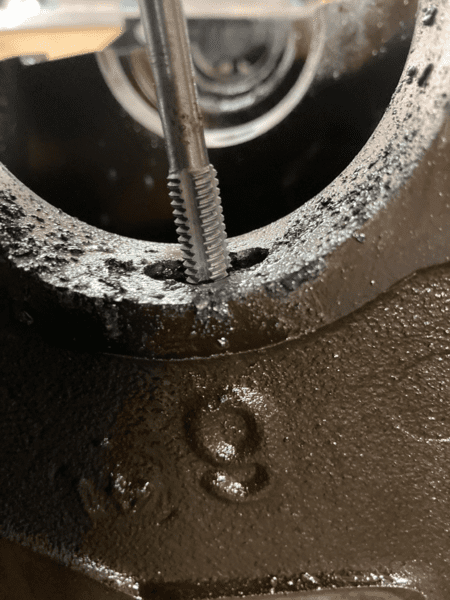

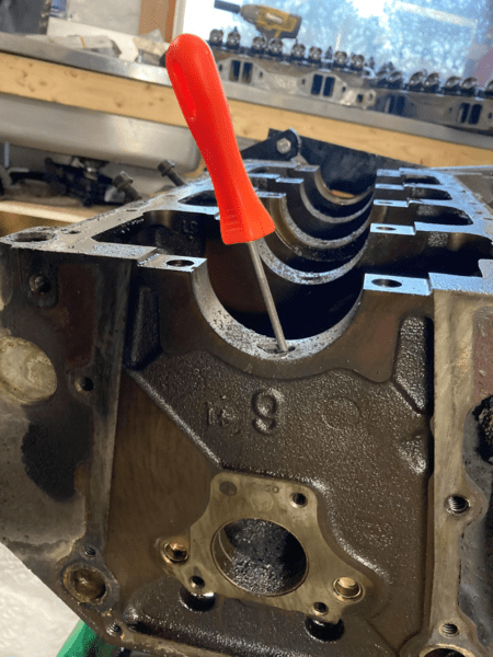

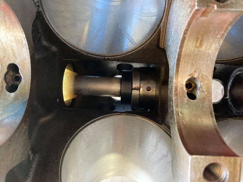

I did some oiling mods to my 2001 5.9 Magnum. I drilled the main galleys to the main crank bearings out to 5/16". Then drilled/tapped the crank main to cam bearings. Red Locktited in some set screws, then drilled them down to 5/32", just a bit bigger than what the cam bearings require (.110"). I also matched the hole size of the machined face of the rear main cap into the galley, then smoothed the transition with a die grinder. Drilled an 1/8" hole from the main galley to the cam/oil pump gear drive gear. I am doing this so I can take advantage of running a high volume oil pump. I also drilled 1/4" between the factory holes of oil filter plate. Here are some pics of the galley/main/cam oils supplies:
upload_2020-10-11_22-41-0-png.1715611160
On the rear of the left oil galley I pulled out the threaded plug, drilled a 5/32 hole through the center. By doing this, it will spray oil directly onto the distributor drive gear. Also this gets some oil back to the pan a bit quicker as well.

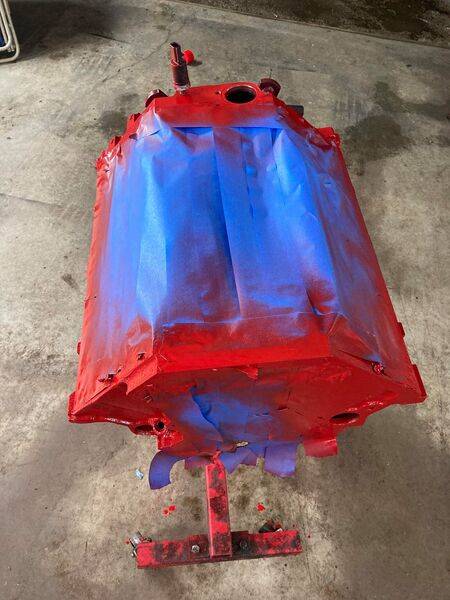

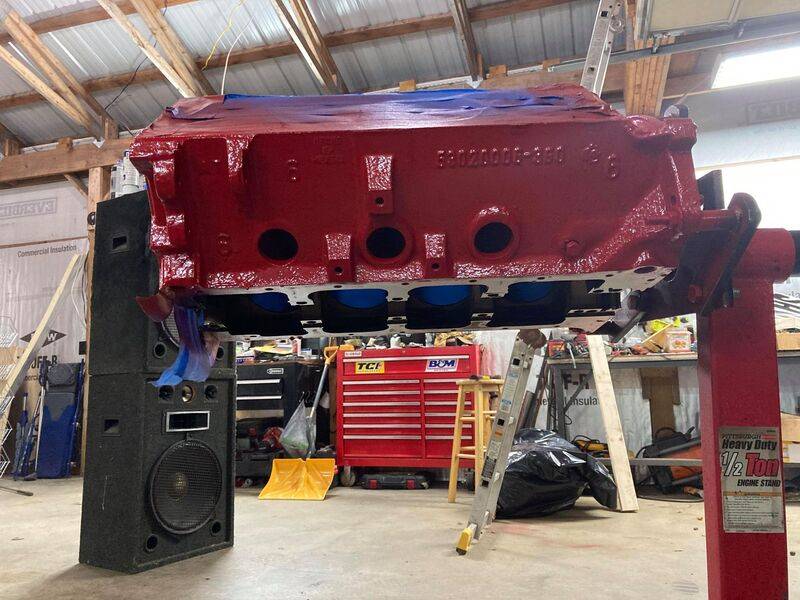

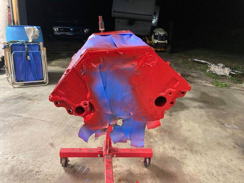

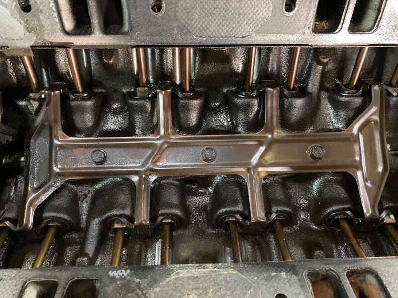

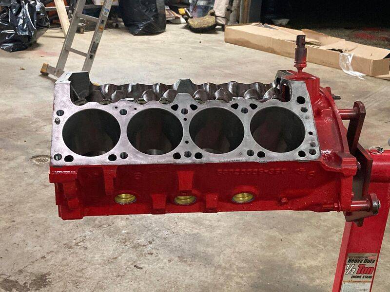

I ended up cleaning up the casting slag in the valley, got the engine cleaned from all of the shavings, got the bores cleaned up with a dingle ball hone, and painted the engine red, with a satin finish. Here are some pics, paint still wet so it looks more shiny than it will be tomorrow.

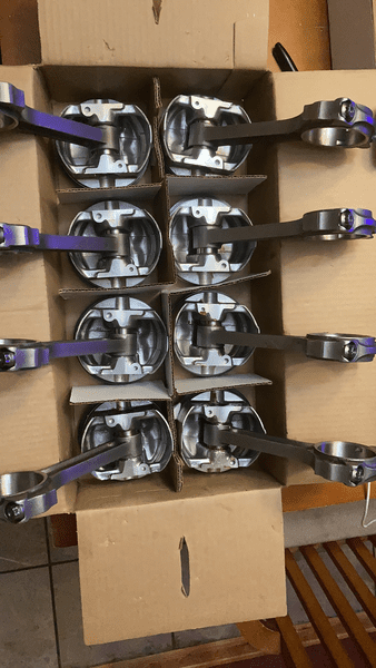

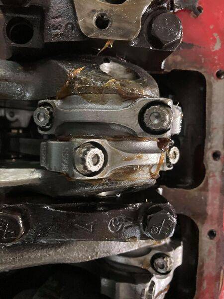

I started assembling the 408 Stroker today. I am running full groove main bearings to give a constant feed of oil to the rods. Main bearing clearances ranged from .0016-.0019". I have nice sore fingers after installing 16 spiral locks without a tool, but all the floating pins and rods are installed with assembly lube. Looks lie I am running 5W20 based on my clearances.
621405_n.png?_nc_cat=106&ccb=2&_nc_sid=ae9488&_nc_ohc=FB3MnWtdPZAAX8ENcrT&_nc_ht=scontent-ort2-1.png

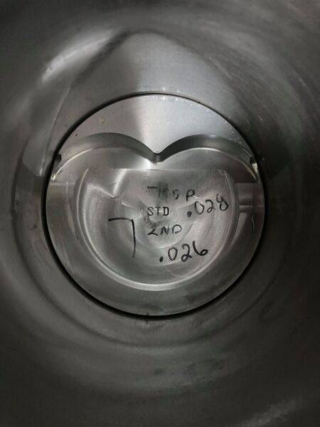

All the rings are measured to spec for KB Hypereutectic pistons. Bearings are all in spec on the slightly tighter side (0.0016-0.0019 mains), lathered in nasty, icky, snotty assembly lube. Pistons are all installed, crank rotates nicely and getting ready for the next step:

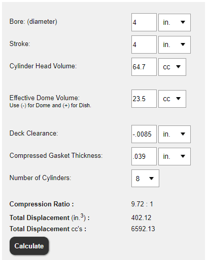

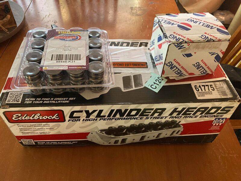

So after deciding to buy a set of Edelbrock Aluminum Magnum heads, and then calculating my measurements, this is what I am coming up with:
136408_n.png?_nc_cat=106&ccb=3&_nc_sid=ae9488&_nc_ohc=XM96DCzrY_QAX_0kvGA&_nc_ht=scontent-ort2-1.png
Which head gaskets? The common FelPro blue are 0.039” compressed I believe. Your calculator is also not taking into account gasket bore... small detail, probably not significant.
You are correct. I also read that I should have the Felpro "pre-crushed 1008 head gaskets for this head. I re did the calculations (added the head gasket CC's to the 58cc heads) using the Summit Racing calculator.

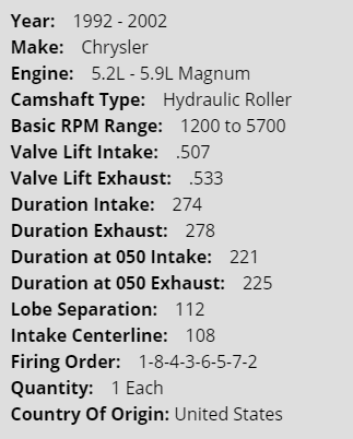

Small cam for a 408
What HP do you anticipate?
I agree, but it is just a fun street car engine. I am running 3.73 gears and 2400-2600 stall converter. I went for a bit more of a torque cam and do not plan on being over 400 HP. I have always been told by an old timer that knows engines to pick the cam that I think that I want, and then go the next size down.
What are your thoughts? And be honest, I am not sensitive or argumentative, I enjoy learning from others and their thoughts.
First I am not a cam expert by any means. I do know enough to be dangerous.
Most people that spend the time and money on a performance engine want to get to full potenial out of it for the street or the strip, then you just pattern your driving style around its potenial.
Many factors go into picking the correct cam for your engine. most builders will pick a cam that will utilize the max cfm flow of the cylinder heads. The heads you have will flow more than the cam will allow, kinda like jogging while trying breath thru a small drinking straw.
Just as important is the cam lobe timing events ie the the timing of the open and closing of the valves in relationship to the crankshaft. This has huge bearing on how much cylinder pressure is crated. If you want a low end torque monster this is very important to be correct.
If I were you I would contact the folks at Racer Brown Cams and ask them for a cam recommendation and then compare it to what you have.
Remenber you can always remove HP but it is difficult to add HP once the engine is built.
