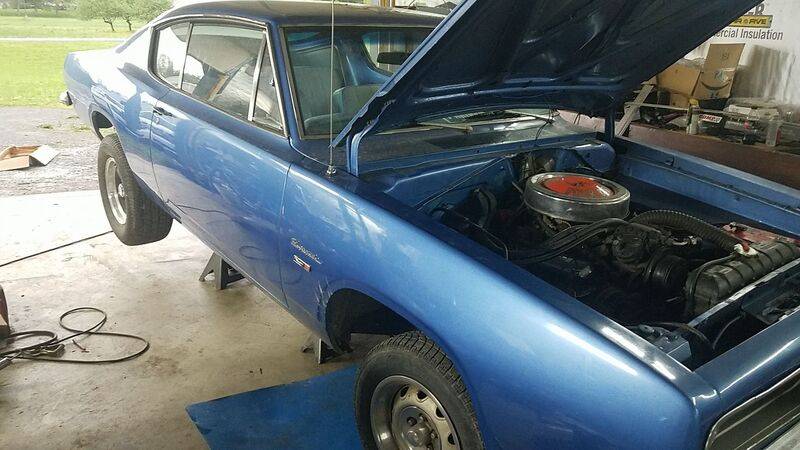

Got a few of the bugs worked out of the Transmission swap. I ended up pulling the valve body back out of the trans and put a Sonnax pressure valve, replaced the pressure spring back to stock, and adjusted the pressure to the higher side of the Sonnax recommended specs.

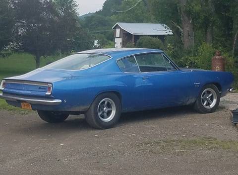

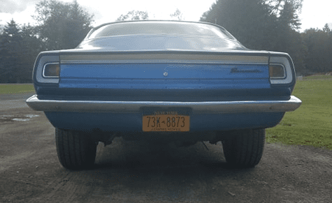

I had 3 pieces of rear truck trim, I didn't realize that the top and bottom were a little different from each other. So I bought the mounting clips from Classic Industries because no one else had them. I cleaned up the trim, added some black around the edge to match what I did to the tail lights, then put on a coat of Eastwood's Diamond Satin Clear, direct to metal. It came out nice, I am happy with the results. When I went to mock up the bottom, I realized that I had two top trim. I went and checked and I do have a bottom, but in rough shape. So now I will search for a 68 bottom trunk trim piece by or trade for a drivers quality top.
I also trimmed 1/4" off from the inner edge of the wheel opening for the tires. If I put an adult in the back seat, the lip would just touch the tire edge on bumps and hard turns. This seems to solve the issue so the quarter lip did not clearance the tires themselves, LOL. I still have not a chance to do the big bolt pattern brake swap on the front because I want to drive the car for now.
Looking good ! I too am cutting my wheel opening lips back do to the exact same issue. The AMD quarters I put on had a 1 " lip so I'm cutting off a 1/4" each side.

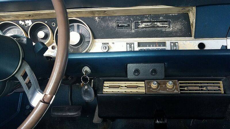

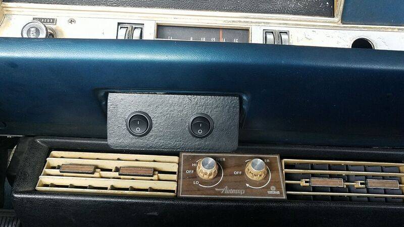

I am still working out a few bugs with the transmission. But I got the switches hooked up for the overdrive and lock up converter. The ashtray was not there and it had an old school FM transmitter in its place. I pulled the transmitter, cut a piece of 2" angle iron to fit, drilled it, and painted it. The switches just provide a ground to the switch, overdrive will only come on when in 3rd gear. The button on the left, closer to the driver is for the overdrive, right is for lock up.

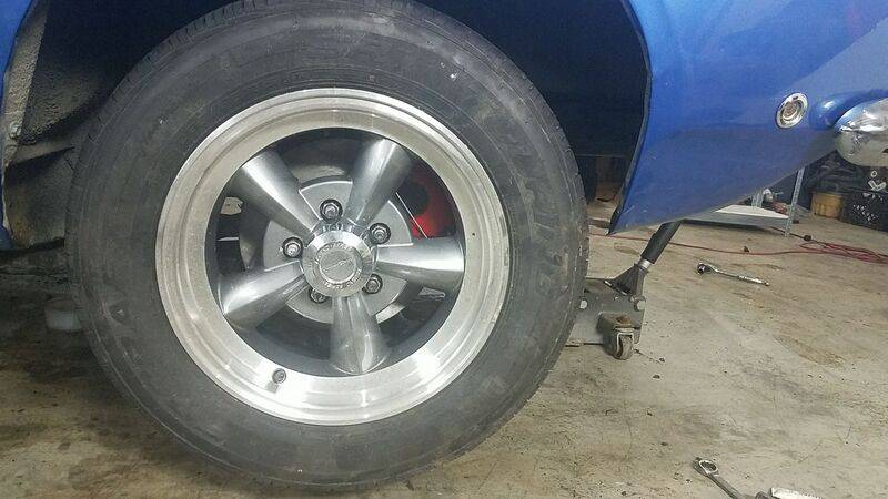

Been driving the car a lot so not many updates. I took the weekend and installed QA1 tubular UCA's, poly strut rod bushing, rubber LCA bushings, PST 1.03 bars, drilled/slotted disc brakes and rotors, new inner/outer tie rod ends. Now I just need to bleed the brakes and get an alignment.
...and drive it you should, looks great!

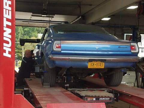

Just took the barracuda to get the alignment done after all of the upgrades. Came out great, very happy with the car overall. All new bushings, tubular control arms, ball joints, tie rods, and shocks are by far the best upgrade..... so far.

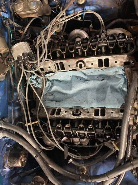

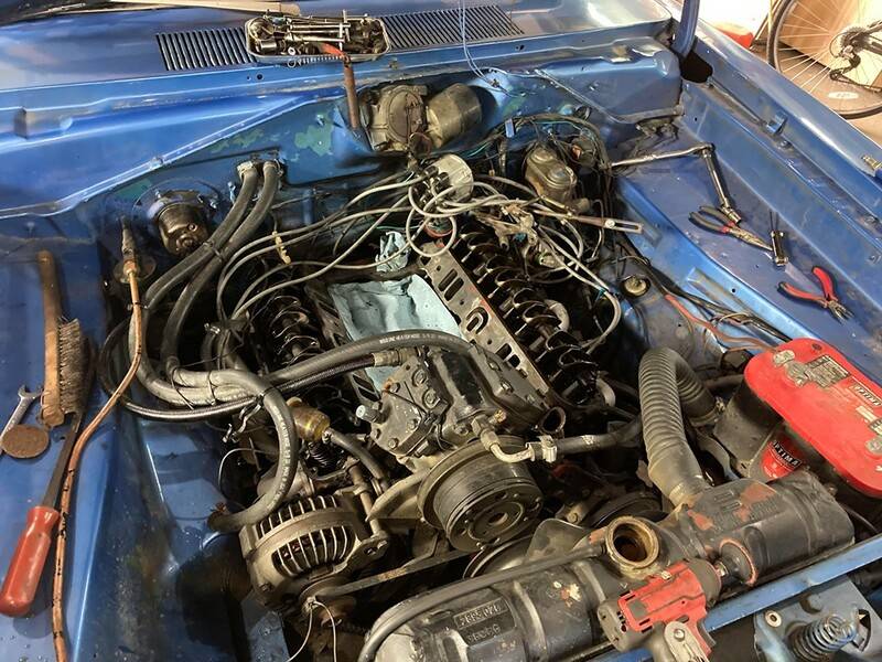

Started chasing a miss at idle and slight acceleration. Then getting a decent drip front he rear of the engine. Sprayed a little brake clean on the intake ports and the car about died when hit the #6 and #8 cylinders. Took the performer intake off the 318 and got it all scraped, brake cleaned, and whizzer wheeled

I accidentally got the AC compressor wire caught between the intake & head once (over 35 years ago). Not only did I have a vacuum leak, but the AC kept blowing fuses.
