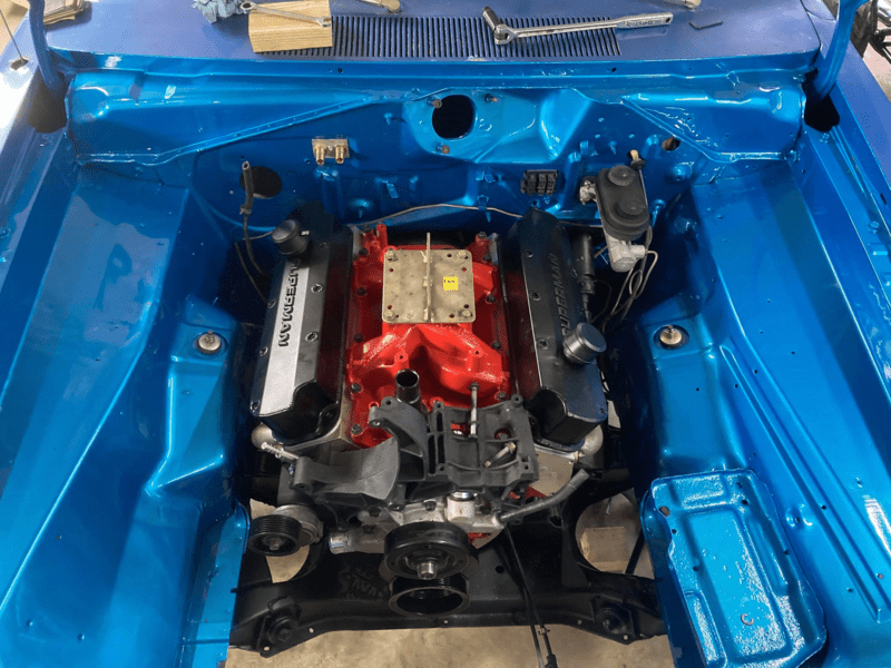

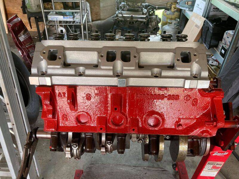

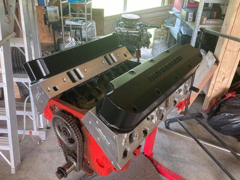

I appreciate the info and opinions. I built the engine on a "budget". As cast Eddy heads, cast stroker crank, and Hypereutectic pistons. I probably will not switch cams at this point, so we will see how it works with the set up.
That is a “conservative” streetable cam for that size engine. With that duration and LSA you should have a good amount of vacuum as well. It would even work well if you decided to go with EFI.
That was part of my decision, planning a Sniper EFI for my next mod.

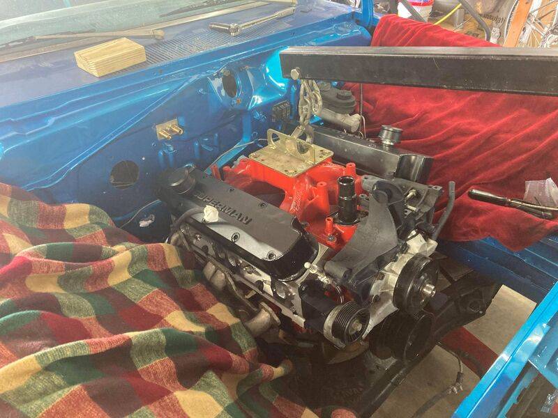

My oil pump started failing from time to time on the stock 318, so I had to startt getting my stroker done.

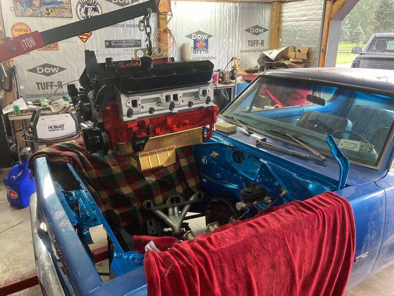

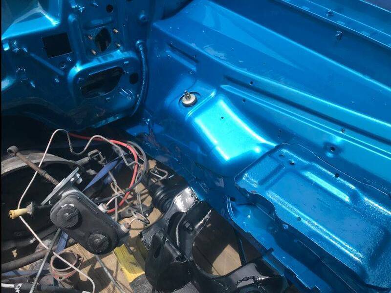

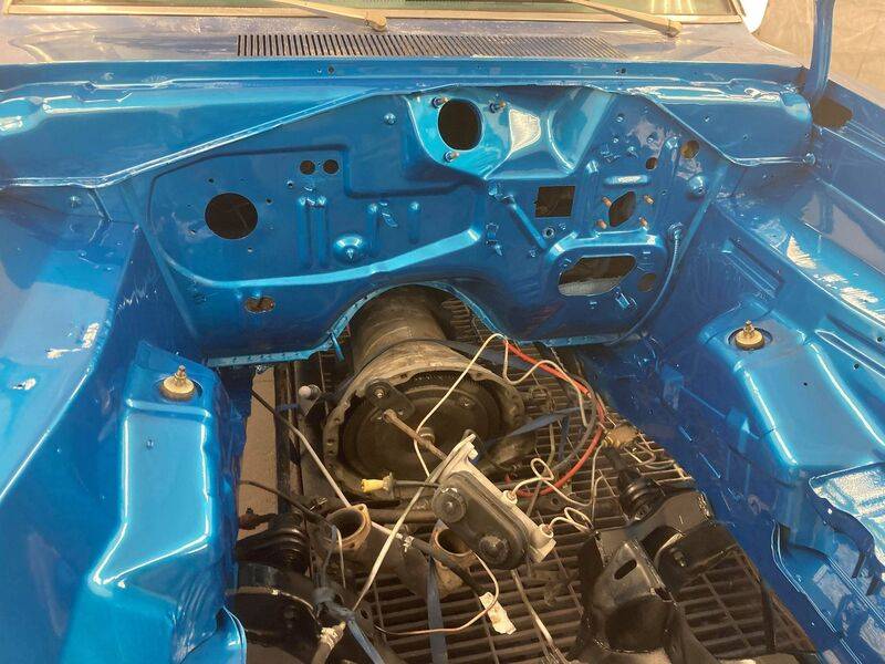

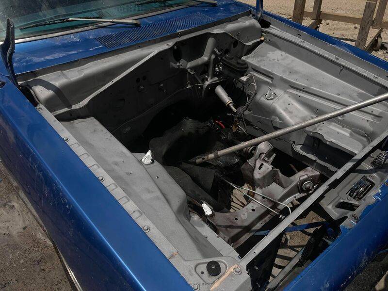

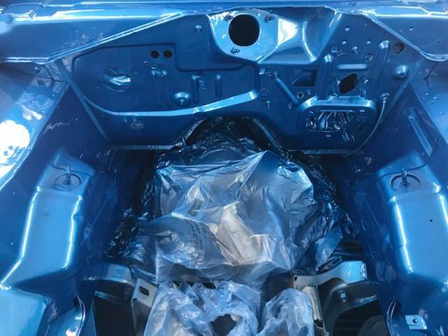

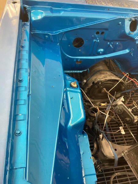

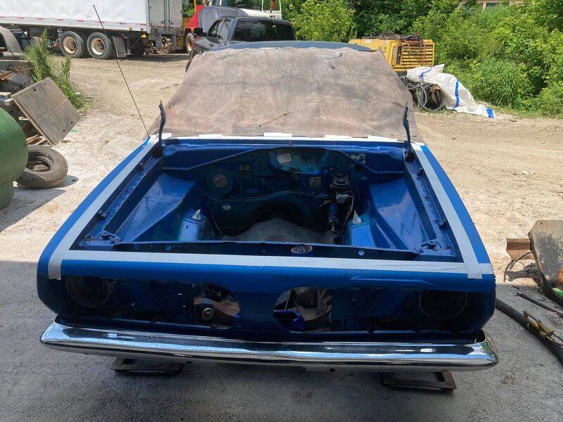

I finally blew up the 318 that was in the car. time to get the engine bay water blasted and repainted before the new engine goes in.

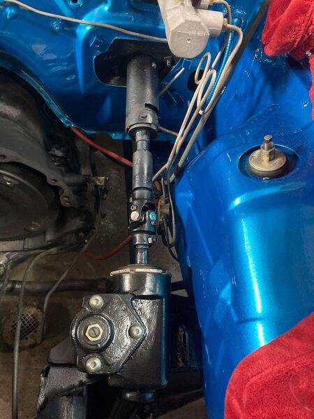

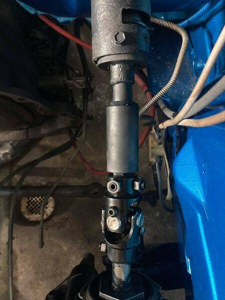

I got the new 16:1 manual power steering done. It was pretty easy to convert with the engine out:
06&ccb=1-3&_nc_sid=ae9488&_nc_ohc=R_UfF--OoT4AX8llS_H&tn=AZuiI6a0jx1vyDl6&_nc_ht=scontent-ort2-1.jpg
9998_n.jpg?_nc_cat=105&ccb=1-3&_nc_sid=ae9488&_nc_ohc=vUqZZZSF87MAX_H6nal&_nc_ht=scontent-ort2-1.jpg
I just bought a 3/4" 36 spline, 3/4" DD generic universal online. I then had a round coupler with an attached 3/4" DD shaft. Cut length to fit and slid the round over the stock Mopar column, welded it to the stock shaft, and slid it all together.

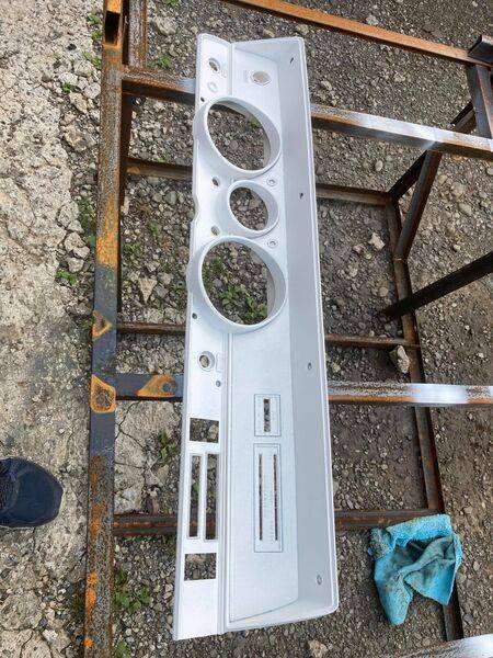

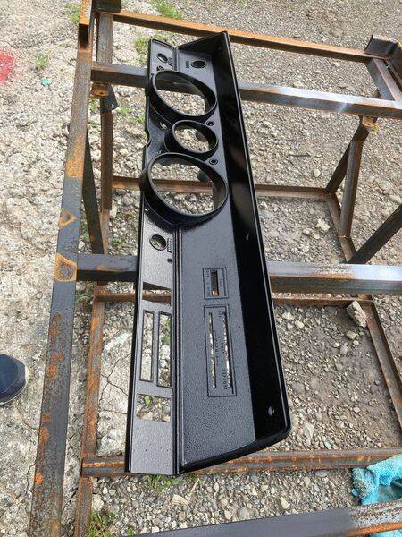

Also pulled the dash bezel out and hit it with some plastic, high bonding primer, and then some single stage matte black. It is still a little wet in the pic, but dried just as I wanted:
