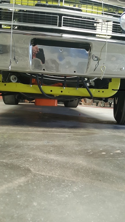

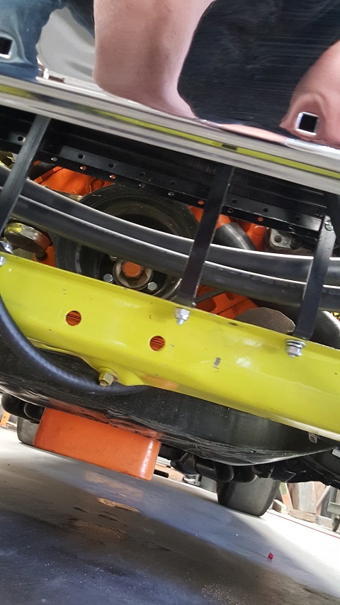

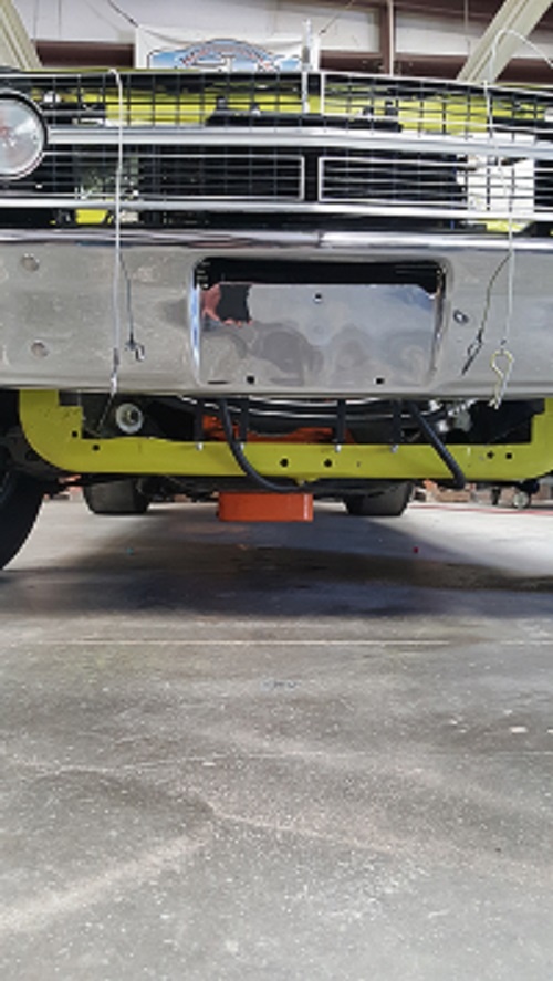

A call to Ron Davis radiators here in Arizona netted some vital information to properly diagnose block pressure and flow characteristics throughout the engine. They recommended I purchase an inexpensive water pressure gauge ($11.67) from home depot and install it using an available water port. This is the same gauge one would use if checking their home water pressure from a water spicket. I had already researched water pressure and flow characteristics online but did not think was relevant in light of using brand new 440 source parts. After all, wouldn't new parts perform great out of the box? My research proved otherwise! It turns out that block pressure should run around 15-16 psi at about 2000 rpm. I installed my newly acquired gauge using an available water port and had 8 psi at the gauge 2-3000 rpm! It does not matter if the thermostat is open or closed or if the water is hot or cold with this test according to Ron Davis. In this case Ron suggested I install a factory 160* thermostat instead of the high flow unit in order to promote increased pressure. No change. Next step was to replace the water pump as Ron informed me that most aftermarket water pumps just don't work well. He recommended a high flow Edelbrock but I had already purchased and had on hand a brand new FlowKooler unit along with a Mopar performance aluminum water pump housing "just in case". I assembled them with new Fel Pro gasket, re-used my high flow Mr. Gasket 160* T-stat, painted, and installed them. BINGO! An instant and obvious improvement in pressure to more that 20#'s at 2000 rpm was witnessed. I turned my attention to the flow characteristics through the radiator and WOW! The flow differential at idle when the T-stat opened up was greater than I had observed at 2000 rpm with the 440 source parts installed. It now takes 10 minutes for the car to heat up to 180* at idle vs. the previous 3 minutes and the heat coming off of the top of the engine is noticeably less. The car is still at my Dad's shop where I have performed all of the work. I was not able to take it out for an actual test drive as there were customer cars in the way and he left town for the 4th of July weekend. Dad will take it out for a test drive this week and if things still aren't the way we like them we will have a new aluminum radiator made for it.
The verdict is as follows. In my opinion and based on diagnostic testing, the 440 source parts do not perform well in a mildly built 440. They do not provide enough flow or pressure through the block to prevent steam pockets and cavitation. I reached this opinion by addressing all of the fundamentals in a step-by step, chronological fashion So far I have addressed fuel mixture, timing, performance of the distributor curve under advance conditions, fluid capacity, air flow capacity and air flow velocity at idle and at speed, fluid dynamics relative to mixture, flow, and pressure. I harbor no ill will towards the 440 source company or their products. There are more efficient options!
Included are pictures to show the radiator position prior to modifications. Also, The modifications themselves, and some pic's of the differences between the 440 source water pump housing and Mopar performance water pump housing. My hope is that this will help some people sort through the rhetoric and emotional posting that occurs when trying to find a solution the their cooling woes.
I will post sometime soon with the results of the rest drive, more pic's of the finished product, and details of any other changes made if necessary.
