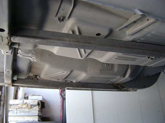

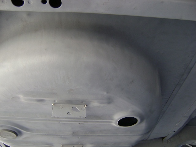

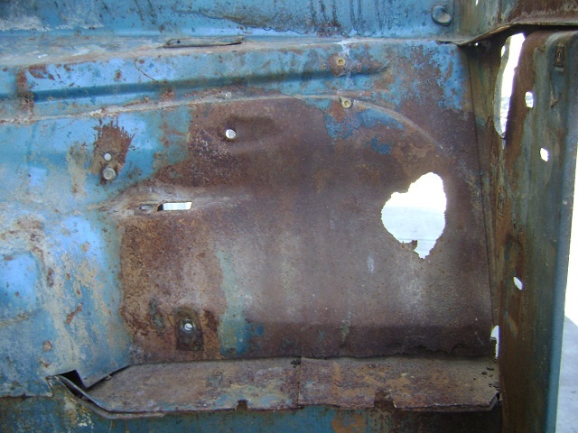

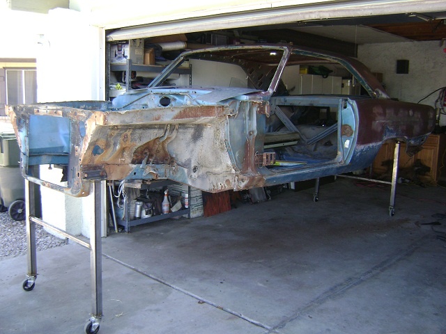

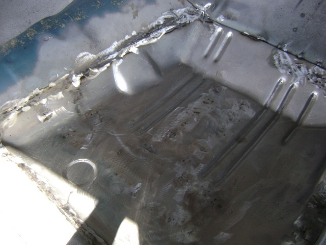

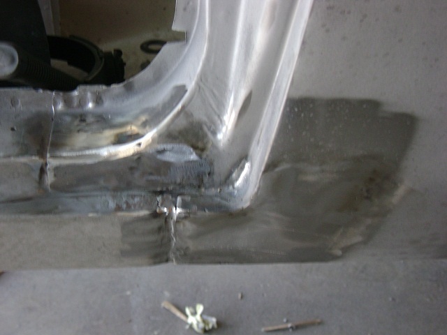

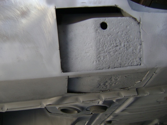

Hello all. The platform is a 1969 Dodge Dart no frills no power anything original radio and a/c delete car. I have completed all SS/Hurst mods including rear fender openings, inboard spring perches, 69-68 fender mods to allow use of 1968 grill and headlight bezels, subframe connectors, etc.. Originally purchased in Texas and later in Arizona where it sat for the better part of 25+ years. I started this project about a year ago and it's getting expensive now :). The color is curious yellow and will sport a black bumble bee stripe soon. Attached are some pics of what I started with, some of the minor rust issues, and disassembly progression.

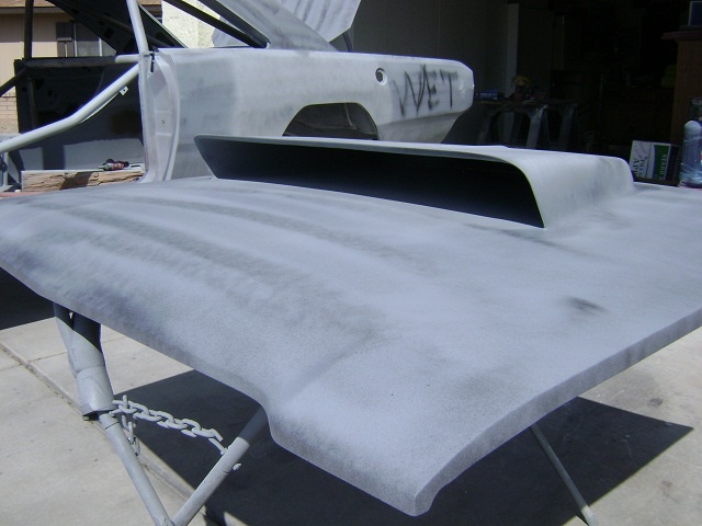

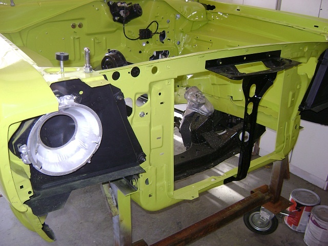

More pics of progress up to and including final prime. I have prefit and adjusted all panes and dry blocked 3x at this point to get everything just right.

Did you use templates for those wheel well cut outs? Mind selling them to me? I could use em!
Hello,
I used my dad's templates made from sheet metal and taken directly from an original LO88 car (Factory original Hurst built car from 1968) He (Greg Fernald) may sell templates to you. You can find his contact information on his website at www.ssandafx.com :).

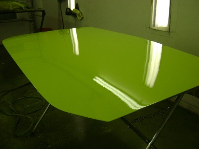

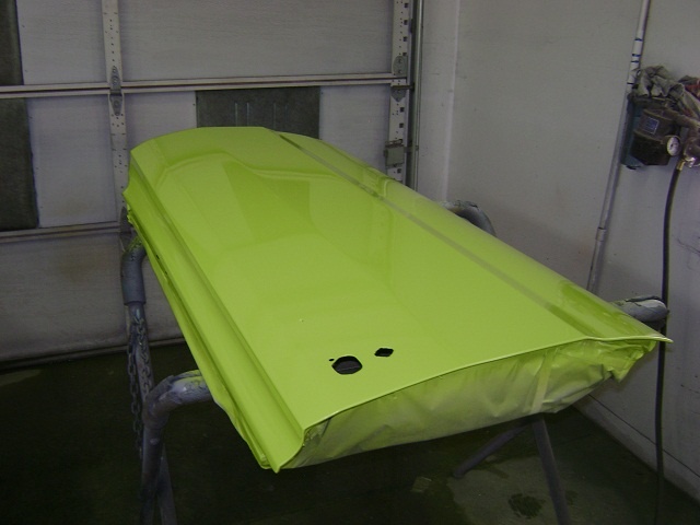

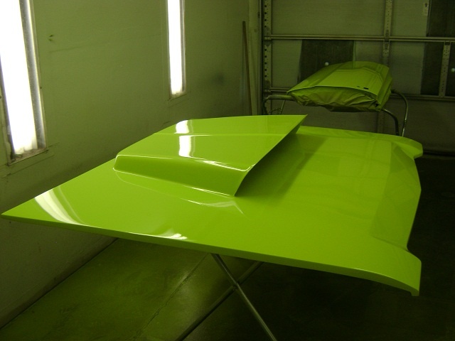

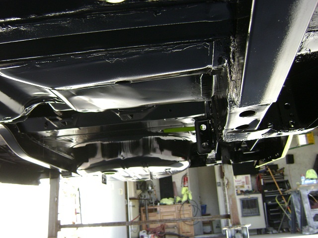

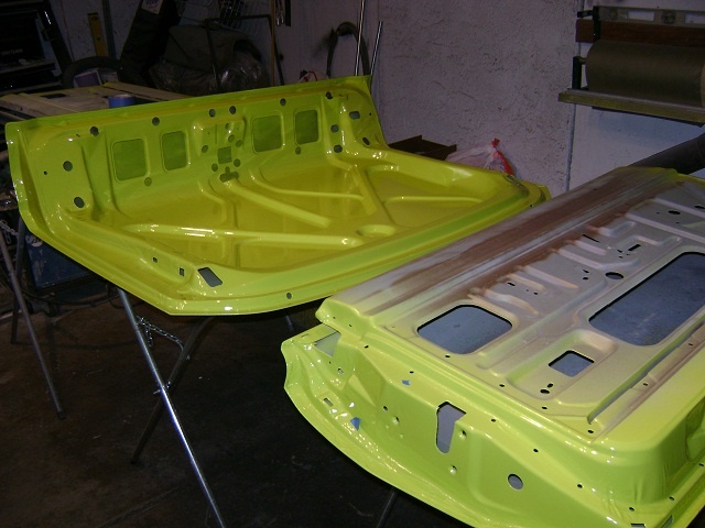

More pictures of 69 to 68 SS project into curious yellow. These pictures show a lot greener than it looks in person. I was going to go with arancio borealis orange by PPG for Lamborghini and changed to this unique (curious) yellow as a lot of people are going orange on their show cars and want something a little different and more factory. More pics to follow these as I have color sanded since these and buffed the entire car and am starting assembly. Stay tuned.
