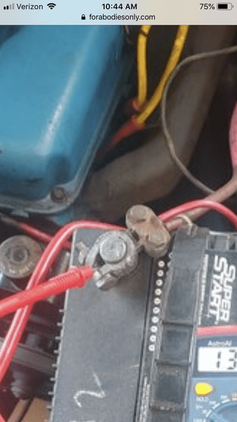

Yea your voltages sound about perfect now. 13.xx at idle and 14.xx at Cruise is what you aim for.

So far as the battery you need to get it "up and normal" and run it awhile. It may be old, or sulfated, or otherwise damage, or it just still might be low. "Back in the good old days" we would have used a hydrometer. People claim that voltage tells if a battery is charged, but it is way too easy to get fooled by "surface charge." Once it is "up" fully charged you might have it load tested. Most anyplace that sells batteries or Oh'Really's can do this. IF the thing can be accessed check the water in the cells

So I charged the battery for 12 hours on a battery tender.
Slapped it in this morning and fired the car up.
At idle the battery read 12.70
at cruise 12.76
The car started sputtering as soon as the headlight was turned on.
Then it quit charging. It should charge 14 plus volts at a fast idle.....around 1500 RPM.
Drove around the block and now it idles at 15.36 and sounds great!
Hmm. I turned the car off and came back 15 minutes later. Turned the car on and then turned on the head lights. Started making knocking noises. They went away after 4 minutes running. Those noises were what it was doing before, when it would start to sputter and die.
After it has some time to run, the voltage on the battery goes higher and the knocking goes away. Maybe my battery is bad and it isnt holding enough charge?

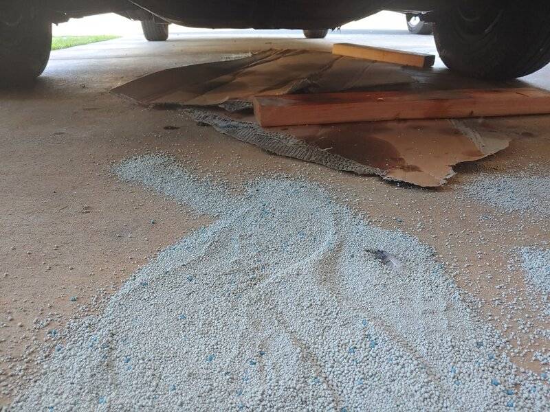

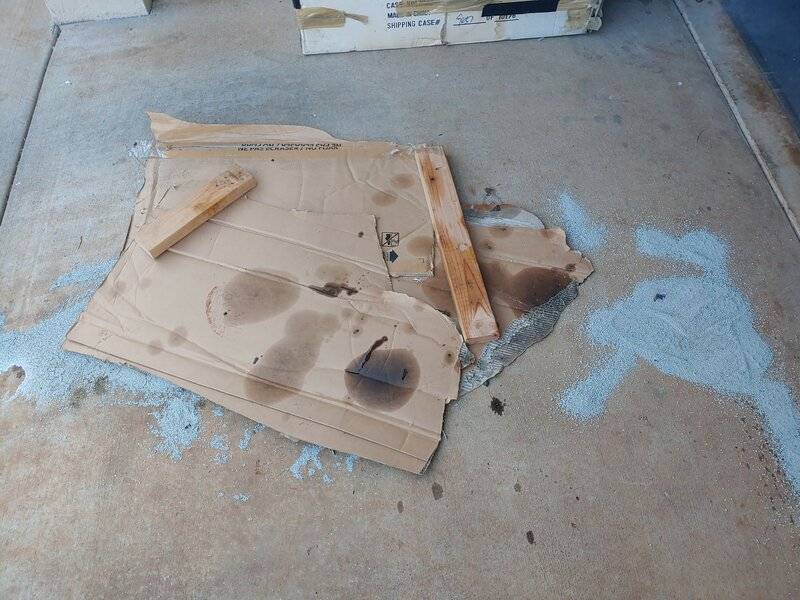

So I clearly have an oil leak. I'd like to fix it but am unsure where to start. I guess a good place to start is to locate the exact spot it is leaking from.
Thanks. Topped off and the car is running smooth. Oil leak is next problem on the list

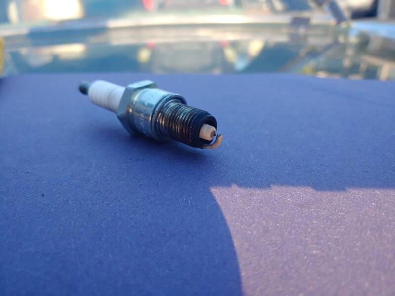

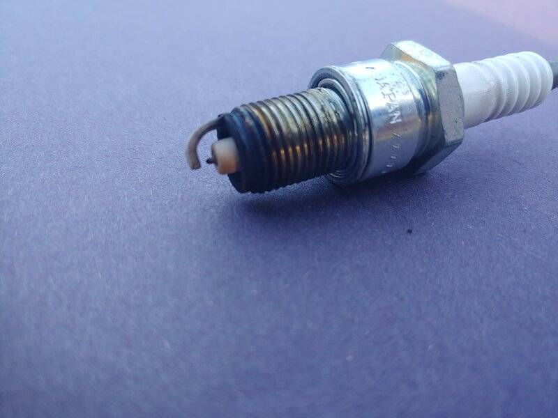

Post some close up pic's of the spark plugs so we can see what is going on inside this engine.

So the leak is pretty fast. I took it out for a quick drive to check the transmission after I topped it off. I see droplets actively falling.

I am pretty sure spark plugs are new. I'll pull one out completely and take a photo.

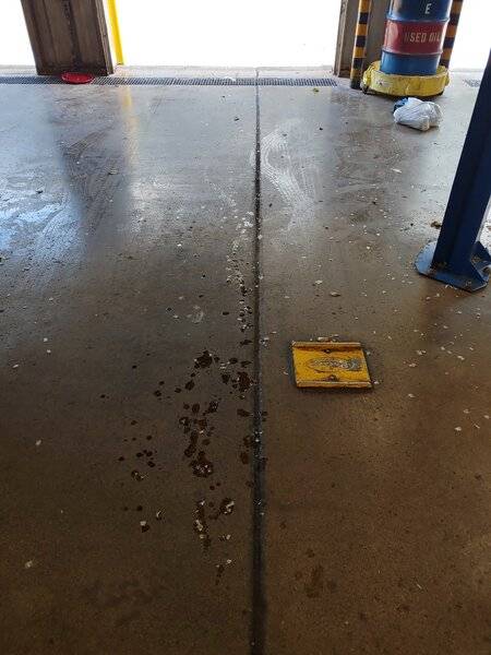

The best place to start is your local car wash. Hopefully with a steam cleaner. Make sure it’s ok to do the engine. At mine I have to go to the truck side. But they’re ok with me doing the engine there. Get it clean then it’ll be easy to see where it’s coming from.
The condition of of the plugs you pictured appear to be OK, but that is not the correct plug for a stock 273. I believe most of the forum members use Champion RN12YC
This will help
Spark plug reading can be complex and sometimes frustrating task this page will help make it easier and the results rewarding
This will help

Going to replace the plugs and source some non-ethanol fuel.

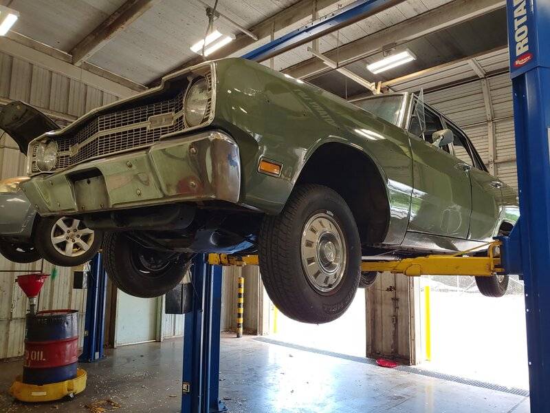

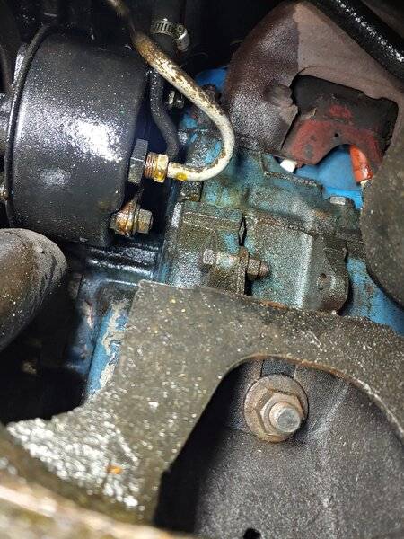

Put the car on a lift today to start looking for the leak. I think the leak is coming from around here. The car is a real mess of oil underneath. I need to get it to a pressure washer and search again. Figured I'd take a look in the mean time. This is where I saw the cleanest looking droplets of oil. Everything else was very dirty.
