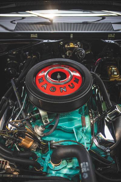

Master cylinder was natural and left to rust. Cap was gold iridite, hold down clamp and bolt were silver phosphate. I will try and find some pictures I have but they were on a computer that just died, so I am trying to recover. Most people still paint the master cylinder black, especially people who like their cars over restored...
Here is a picture of the 1968 Mr. Norms Dart GSS that I helped restore, they are identical on 1969 Dart GTS 440 M-Code also...
Beautiful restoration. I've seen a couple of restored cars with bigblock engines having chrome valve covers. Was that an option on HP engines? I've never seen them on smallblocks. I know Hustle stuff had them.
The 383 Darts and Barracudas all have factory chrome valve covers, the 69 440 A-Body's all had painted valve covers. The GSS's had chrome valve covers because that is the way Mr. Norm wanted them...
