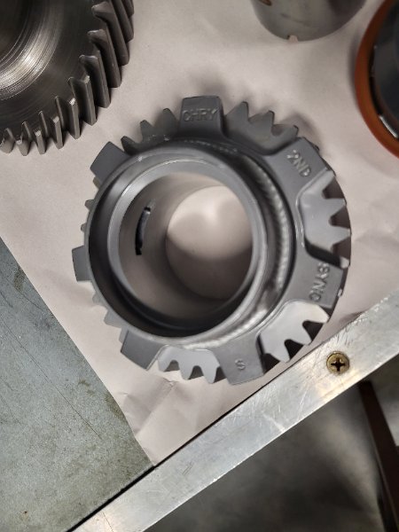

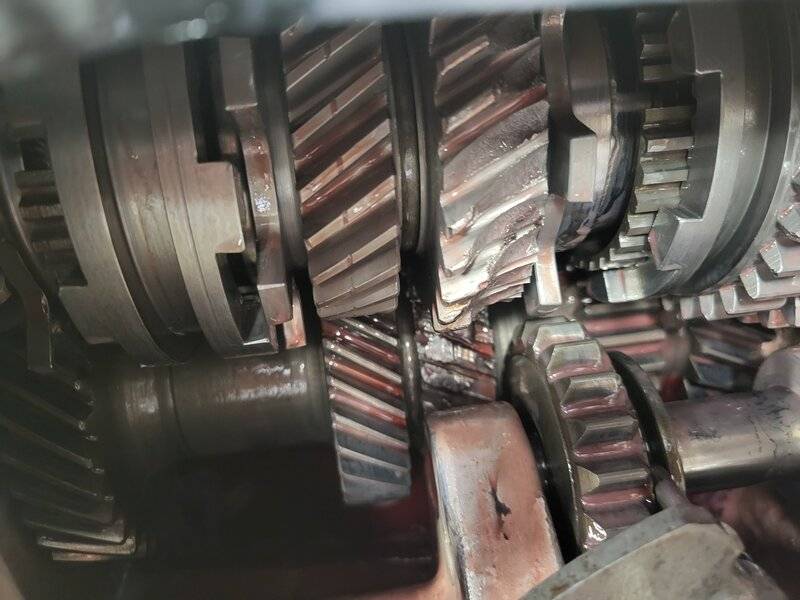

I spoke with Dan Brewer about my issues.
The Liberty set I bought from him a few years ago was not shot peened or chryo treated.
My 2.66 set I ran when I first started with the Colt was.
Now did this set break because of fatigue, shift shock, or because it was not treated.
I asked Dan to see how long Liberty might take to treat another gear and cluster.
He is checking for me now.
I think I will just install the 2.66 transmission now and get the 3.09 together over the winter.
Man there was a LOT of metal in the case.

Would a slipper type clutch help with shock and help reduce breakage?
Like Advanced Clutches or Black Magic.

My take on that failure is reasons 2 & 3, exacerbated by the the larger 1-2 gear jump & heavy rotating mass....that nuclear option at the bottom sure would be sweet, have to take a hammer to the big piggy bank tho'..
Hard to say, others have had good luck.

Dan Brewer took care of all of what I needed.
He sent the gears to Liberty.
When I first put the 3.09 gear box together I bought an aftermarket Aluminum Front case.
So with the the Liberty Gears, bearings, small parts, billet front retainer it was around $1300.
Trying to budget for a "Real" race transmission.
A TCI 904 is $2300, a converter is $600-$1000 so going to a slush box A'int going to happen.
