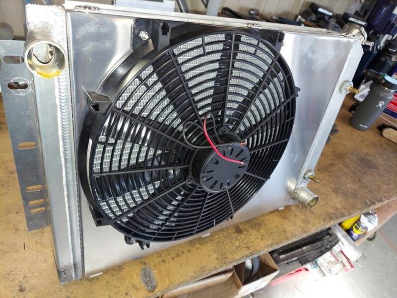

Got the radiator shroud made and the electric fan mounted. This fan supposedly pulls 3000cfm, so we'll see how it works. I had to offset the fan due to the water pump pulley.
