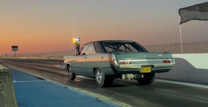

Had a GREAT T&T session at the track last night. Got to test the 2-Step/Transbrake and the Air Shifter. Managed a 6.975 @ 96.75 mph on No Prep. I was being extremely conservative with the low shift RPM of 5,800 RPM. The launch was set to 3,000 RPM.
She's got A LOT more in her when I turn it up next season. I believe she's got a 6.7XX in her with a prepped track and good air.
Pay no mind to the reaction time. Lol. Last night was all about making sure the 3 new systems worked together.
Overall, a very successful way to end the Season. I cannot wait for next year when I finally get to add the Nitrous :):p
