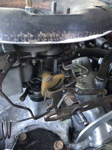

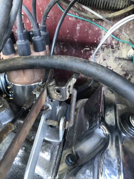

Can u show us the end of the carb rod at the pivot? It should be straight up and down. But for sure u need to have the slack out if the top rod. Kim
I will get better pics and a video tomorrow something is up with this set up I believe

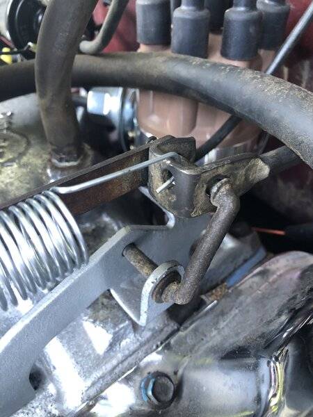

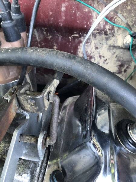

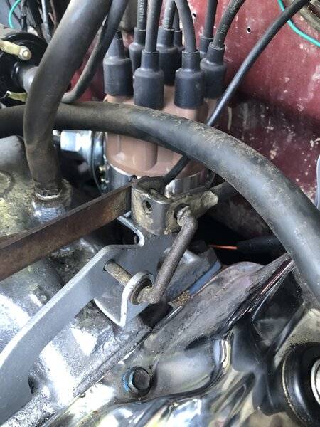

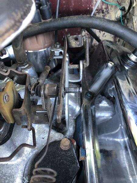

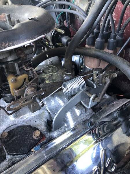

Does anyone see anything wrong with this kickdown?? It’s a one piece rod back to the lever and no matter how I adjust it on the kick down lever the lever does not go all the way back at wide open throttle and the lever doesn’t start moving to about 1/2-3/4 throttle

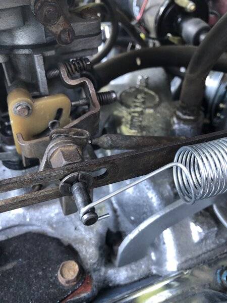

This is how it looks with spring that’s on there
So if the little rod that looks a little like a backwards C is supposed to be straight up and down at rest when on slow idle. Then the slider bar will be against the pin or so it looks like that would be the case. But then ur saying u won’t have full kick down? Kim
I sorta bent the rod and adjusted the throttle cable some and it’s working. Tranny doesn’t seem to be shifting right though. There is a slight hesitation I did feel it kickdown though
Well it’s kicking down at wide open throttle. So I think tomorrow I will try to drive it some. And see about the brakes. I hope this transmission is ok!!!!!
