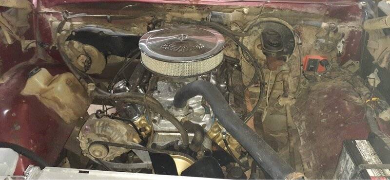

It has dual exhaust but stock manifolds. That’s why I’m thinking headers or maybe magnum exhaust manifolds from 92/93 maybe. Has a ignition upgrade now. Supposed to have a cam- small rv cam but I’m just gonna say it’s stock cause I don’t know for sure if it’s been swapped or not
Pic of motor
I myself would skip the Magnum manifolds since there gain is not big over the stock parts. A noticeable gain is not what they would provide unless you thought out the build completely. Headers would be the way to go.
