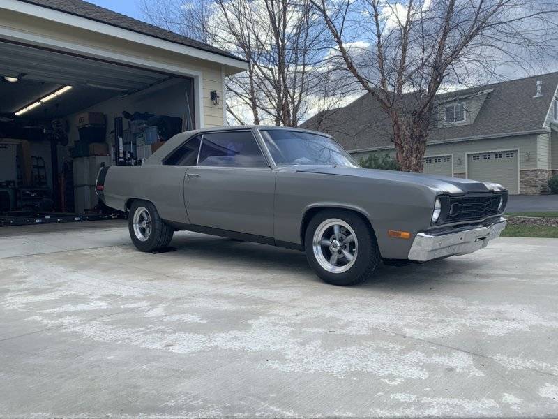

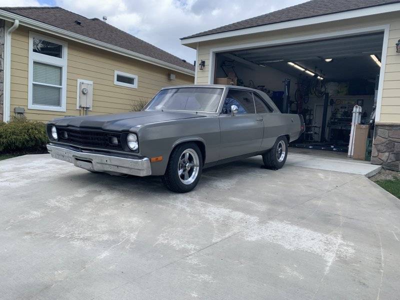

1973 scamp front tire size.
225/60/15's on 15x7's with a 4.25" backspace

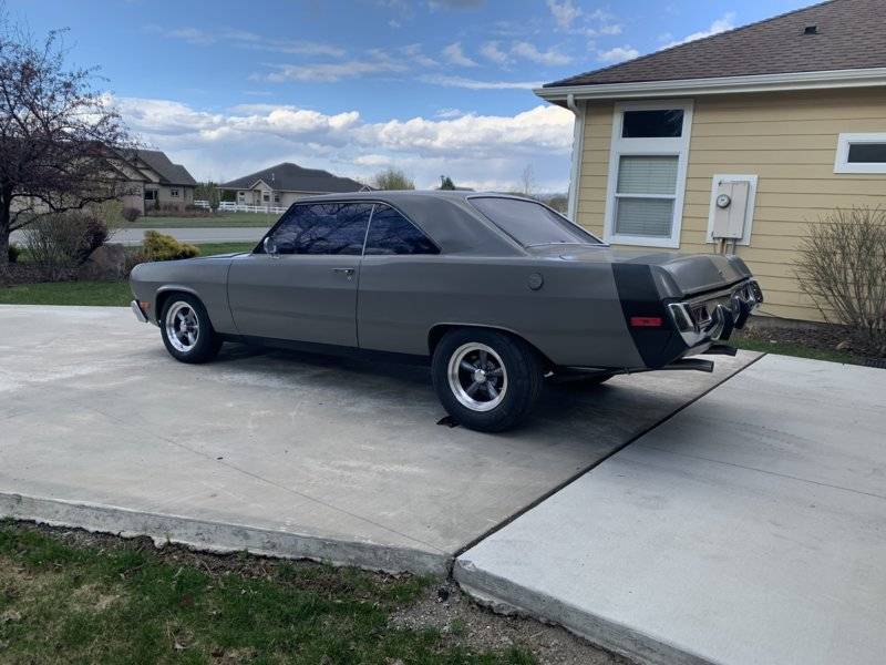

In the photo above, the front wheels are 15 X 7" and have 0 offset. The rear wheels are 15 X 7" with +6mm offset. The front tires are 195/65R15 (25" tall) and the rears are 235/60R15 (26.1" tall) M/T drag radials.

I went with the 195/65-15s. On the 15x7s. 255/60-15s our back
7" wide wheel, minimum tire 195 ideal 205 or 215 max. 225
4.25 back space may be too deep for your car, I would go with the 3.75 and you still might need a spacer
4.25 is about the max you can go in the front with these Later A-bodies.
I have 15X7 Vision AM Legend with 4.25 BS on the front of my duster with 215/60R15 tires. No rubbing.
I have 15X8 with 3.75 BS and with 245/60R15 on the back I can go bigger with 255/60R15 with no issues as well.
Vision American Muscle 141 Legend 5 Series Gunmetal Wheels 141H5765GM6
I think the OP made a great choice. I guess I better since it is the same one I made. :-) The 195/65R-15s fill up the wheel well nicely and is as close as you can get to a "skinny" on a 7" wheel.
