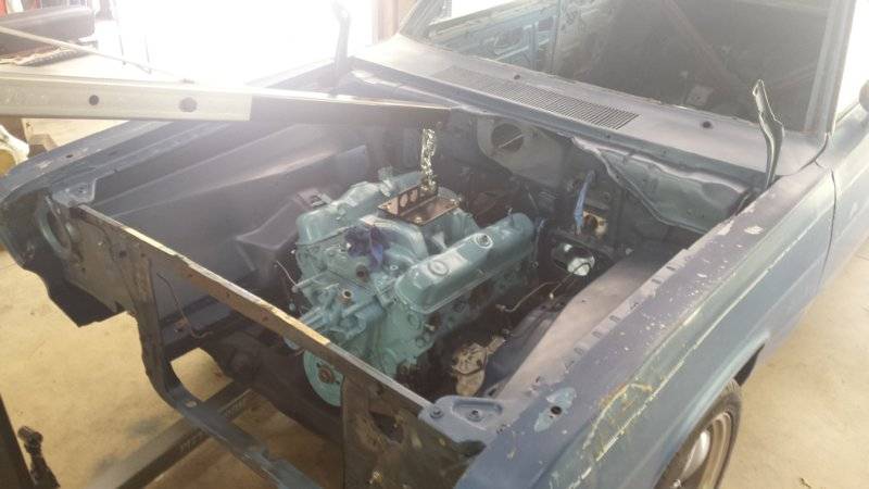

True story. Tried to do it right. Bought three cans of the good Chrysler blue engine stuff. Every can was bad. Spit and sputtered, wouldn't spray worth crap. Taking them all back. Went to Lowe's, picked out few cans of a light blue. That's what I get for buying expensive stuff. LOL
I bought plymouth commando red engine enamel and the high heat primer at pep boys. It layed on nice and shiny. I dont wver buy anything from pep boys, but i will buy the engine paint from em.
Bought chrysler mopar race hemi orange years ago for a 440 i built didnt cover worth a ****. Was watery as heck. Wont ever use their engine paint again.
I used this same paint on another engine, and it has held up surprisingly well. Plan ole Krylon enamel.
Probably do red when I build the 408.
One little issue, got the distributor drive in a tooth off. Tried the ole screw driver coat hanger trick. Wouldn't budge. So I got an old gutted points distributor I had, and a 15/16 socket and spun it right out. Have to remember that one!

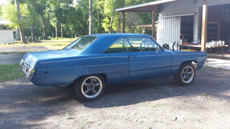

Got her out to sweep up the shop and let her enjoy a glorious Florida spring day!
