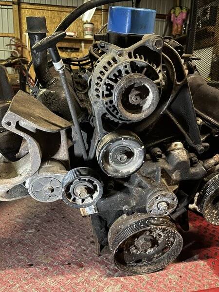

Mine doesn't have a bracket and large idler in place of the AC compressor. Looks very similar to how the non-AC setup for a Magnum looks.

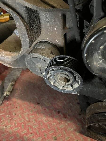

That tensioner is just a spring, right? What's failing on it?
I think in most cases it is a base or mount, an arm and a spring that puts tension on the arm.
In the first failure I had, the issue was that the arm seized to the mount and wouldn't move to maintain tension on the belt. This allowed the belt to slip off and get eaten.
In this case, the arm is no longer parallel to the engine. Not really sure what the failure is, and it hasn't caused any problems so far but pulling a hill at 3000 RPM is not where I want to have one either. I've got a squeak, too. The YT video in the other thread I link above made mention of the tensioner squeaking, not sure if that is the source of my squeak or not.

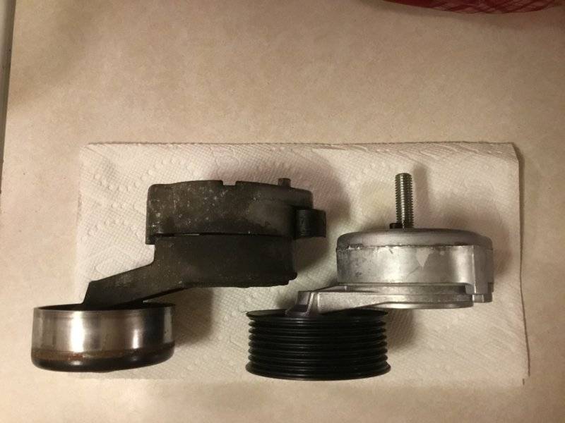

Here's a picture of the idler from earlier in the thread. The '91 part is the dirty one on the left, the other one is a '92+ Magnum tensioner.

Do you mean to use the Magnum tensioner?
Best I can tell, the Taurus one is a virtual bolt on, so no reason to try and mount the Magnum one. And I think the Magnum one tensions the wrong direction, too. But been awhile so I could have that wrong.
Ahh Dig it, OK! My Bad, forgot about the Ford unit!
