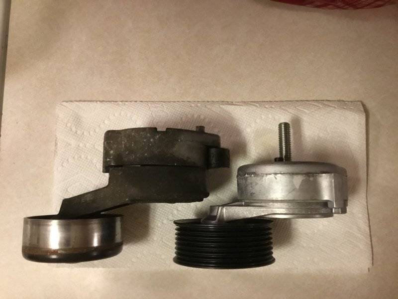

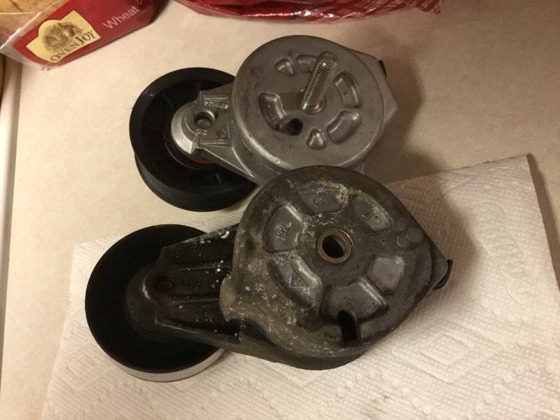

That’s what I was hoping to do, but in a word the answer is no.
I thought I had 2 issues standing in the way of doing just that, but in the end there are 4.
1. The later style mounts with a stud, the early one with a long bolt. There is no way to use the stud, the early bracket is bolted to the head, threaded and has no access for putting a nut on from the back. My plan had been to bore the stud out from the front so the tensioner still had whatever it is holding it together, but allow for the bolt to be used.
2. Location pin is in the wrong place. I planned to either remove the one on the later tensioner and ignore it, or drill and tap the housing to add a new one.
3. The later style is shorter in length than the early one. This might not be a big deal, or it might put the pulley into the air pump.
4. The later style is significantly shorter in offset than the early style. With some careful measurements, maybe a spacer could be made to work. Or not.

Best I can hope for right now is to pull the air pump and bracket, swap on the later tensioner using the correct mount and measure for a belt. And pray.

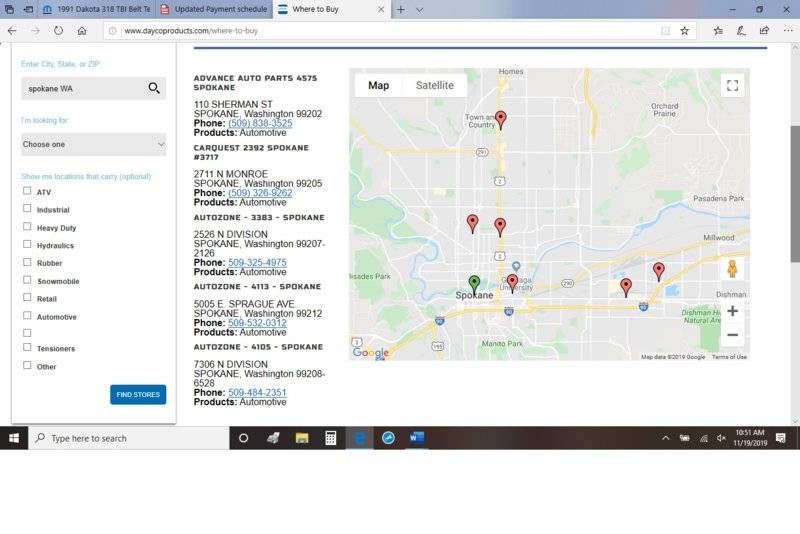

the way I went about it, I went to the dayco site
Dayco Catalog - Unites States & Canada
punched in the year make and model and the part number popped up
http://www.daycoproducts.com/part?oe_number=305315&part_number=89315
then there was a tab called (bottom right of the last page) "need this part?" [find stores]
I clicked on that and punched in "Manchester MD" (because I didn't pay attention and I got you confused with @ragtopfury , so the store in hampstead might not be as close as I thought)
so, once I popped in "Spokane WA" I got this
Where to Buy
since the advance auto store told me he could order it directly from the manufacturer, I would call them first
Where to Buy

It is a Sport. When I went to the Advance website, and entered a vehicle, it only listed pulleys and no tensioner. I will look at those numbers.
is this a dakota sport? i looked at advance and typed in sport w/318 and it came up as dayco 89434 or litens 910556a.
Not sure what those parts are for, but based on the images I found, they won't work. The stock part has a fair amount of offset between the spring assembly and the pulley, those look to be pretty much inline. Maybe they are for a 5.9 diesel?
