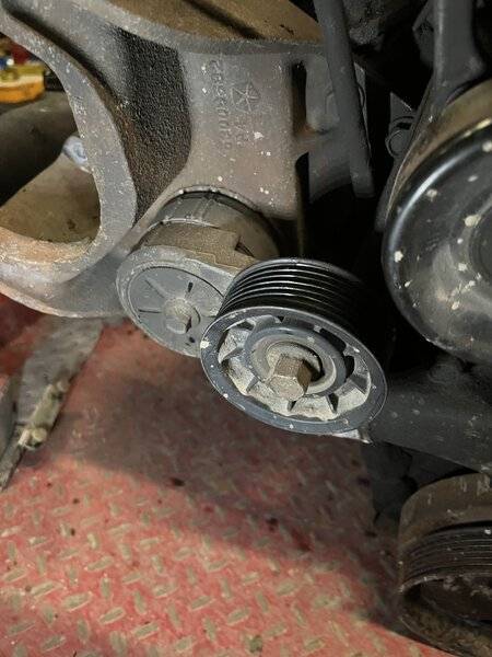

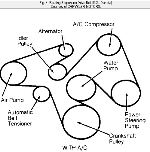

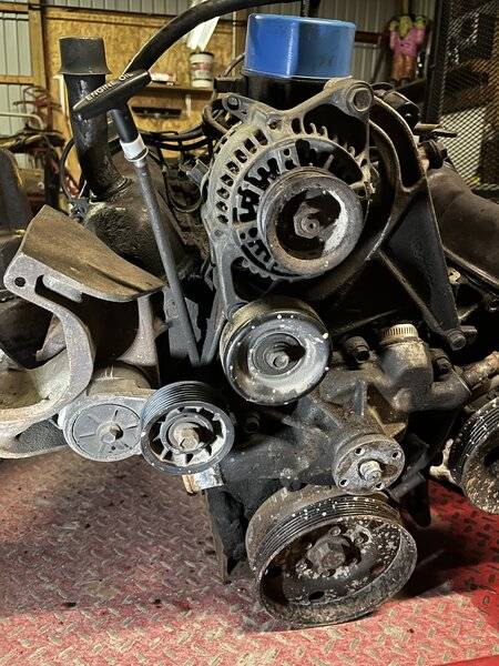

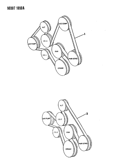

@DionR …..Please post a picture of the belt routing on your truck. The motor in my picture is from a ‘91 Dakota and is a 5.2 but is missing the air pump.
Problem with removing the air pump is the tensioner works the wrong way. Without the air pump (or something similar), the tensioner can’t make the belt tight.
I tried to figure out a way to get rid of the airpump and best solution I could figure out was to swap in a 5.9. :D
What kills Me is that they bother to put a bracket & large idler in place of the A/C compressor to maintain routing & tensioning, yet take a different belt anyway, WTF? The engineers can't figure out how to match placement & pulley diameter?
Thanks Dion I forgot to mention the 5.2 I have came from a non AC truck so another reason it might look a little different
Mine is a non-AC setup as well. Best I recall, the belt routing is similar, but no AC pulley. Goes direct from the idler under the alt to the PS pump.
Mine doesn't have a bracket and large idler in place of the AC compressor. Looks very similar to how the non-AC setup for a Magnum looks.
