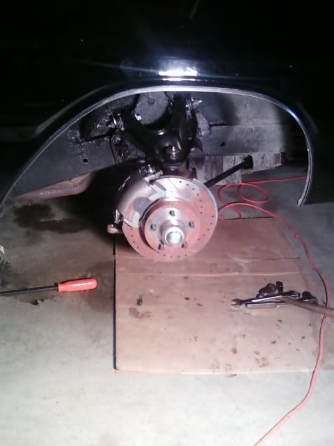

I have a two bolt aluminum master cyl, I think it is originally off of a van or truck. Good pedal, more clearance, cleaner look. Of course, that's just my opinion. Some people don't like the look of modern master cyls on older cars. They're the same guys who don't like my slotted and cross drilled rotors showing behind all four wheels...
Or better yet the guy who spends thousands of dollars on open shiney wheels then paints his rusted stock calipers on the car and thinks it looks good... I personally like 2 bolt master cylinders..its a nice upgrade and updates a muscle car

Or better yet the guy who spends thousands of dollars on open shiney wheels then paints his rusted stock calipers on the car and thinks it looks good....
Lol My brakes are just mocked up right now, so the rotors and calipers have RUST all over them! I'll take them back apart for cleaning and paint. Some day.
