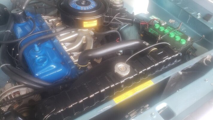

I have a choice between a 22 and 26 inch radiator for my 318 Duster project. Same price, $50. The 22 is 40 miles away and the 26 is 140 away. Both guys say they came out of their Dusters. I'm reading up and finding that early 318 cars have the 22 and the later cars with 360's have the 26."
i have a 70 Demon 6, 70 Duster 318 and a supposed 74 Duster 360 yet all the openings measure the same 22.5" wide. The Demon has a 22 in, the 70 Duster has a 26" screwed in with some self tapping sheet screws which doesn't seem right some I'm thinking it should be a 22. The 74 looks like even though the opening is the same size it looks like it has factory mounts for either one.
Long story I know... I'm putting a 318 in the 74 and am just wondering if the 26 from the 70 is a better choice in the 74 and put the "new" 22 in the 70? Or...the "new" 26 in the 74?
I believe the 26" radiators started in '73 or so- but not all of them got them. Slants and non-ac 318s still got the 22s.
The best way to tell what it originally came with is to measure the opening in the radiator support.
A 26" rad will physically fit the 22" support, it just may not have the wider attachment points for the 26. And running the 26 on a 22 support is kind of an exercise in futility, since you are blocking off a good chunk of surface area on the bigger radiator- and thus not really gaining anything. Unless, of course, you open up the radiator support to the 26" dimensions.
It looks to me like it has provisions for both. I just spoke with the guy who has the 26 and he said it came out of a 73.
The next thing would be the fan size. I think the 22, at least in my 6 has a 4 blade 17.5" dia fan. While the mash-up with what looks like the correct 26 for the 73 and up in my 70 has a 7 blade 17.5 diameter fan. While the opening is smaller the wind on the front has a cooling effect and back side is fully exposed to the fan which I believe does the brunt of the work. I assume the extra coolant has an effect as well. While I'm looking things over I see its missing the coolant overflow canister on the 70 while it is present on the 72 and 74....hmmm.

Anyway... when I purchased the car, the original radiator was history, so I looked for an OEM radiator and found a 1971 26 in. (out of an E-body). P/N 3443970.
Got it rebuilt and now it's in the car. So, I can say "a 26 inches rad fits a slant 6/318 22" rad support" and the cooling is just perfect...:)

The amount of the 26” core that’s obstructed by the slightly smaller opening is pretty minimal. It’s true, the cars that originally came with 26” radiators had a larger opening in the support, but the difference isn’t that much. And it’s not like the core is pressed against the support either, the extra core that’s “behind” the support opening still is exposed to air, so it still works to dissipate more heat than the smaller core.
And more importantly, when does the car run hottest? The biggest cooling issues with these cars are usually at idle or slow speed, when the fan is doing all the work of moving air. If the fan is doing the work, and you’re running the proper fan shroud on the radiator, the fan will pull air across the entire core. By not opening up the radiator support to the full core width all you do is obstruct a little bit of the core when the car is moving at speed, when the speed of the car is pushing air through the grille and the radiator opening. These cars usually don’t have any issue cooling at speed.
My ‘74 came with a 22” radiator, I run a 26” now with an electric fan set up and the original radiator support opening. At speed my fans never run. At all. The smaller opening moves more than enough air at speed to cool the car to the thermostat temp. And at low speed or idle the fans pull air across the entire 26” core because of the 26” wide shroud.
You will have to add the mounting points for the 26” radiator if the car was set up for the 22” because the mounts for the 26” radiator are wider, but that’s all you need to do. Opening up the hole in the radiator support will help move more air at speed, but it’s a small difference.
