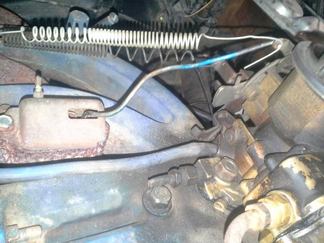

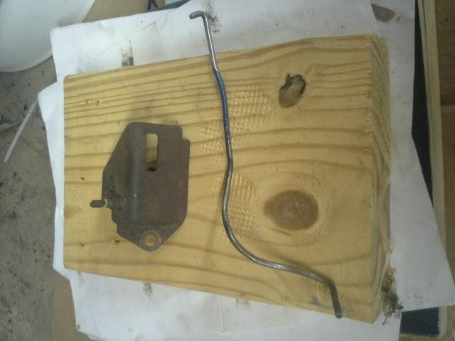

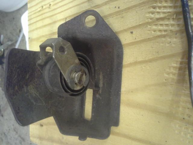

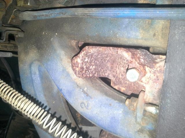

Shoot a pick of the old mechanical one. I got 2-3 unknown years hanging on my wall of shame.
Sorry for taking so long guys life got in the way and iv been in a mad dash trying to get stuff together but here we are
