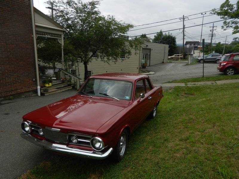

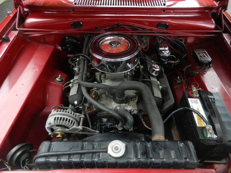

Here's a 318, dressed like a 273, in My 65 Valiant. It has a 904 trans, 8-1/4" rear, and 73+ disc brakes. - The 318 has a 600 Holley, and a mild cam. - This set-up makes a nice driver. - Not a race car. -- I bought it this way, so I don't know the details of the build. ---
