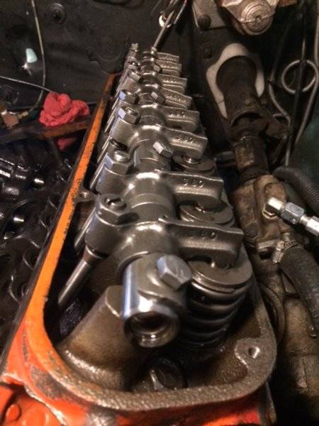

273 hydraulic cam/pushrod/adjustable rocker combination.
Update, after purchasing a pushrod checker, a length of 7.070 gave me a good pattern across the valve stem. I then ordered a set from Smith Brothers Pushrods, they were very easy to work with and shipped them out two days later. I also had to shave .060 off the intake to get the ports and bolt holes to align. Changing the intake gave the car better low end torque and an awesome throttle response. Thanks to everyone for your input...
Not that it makes any difference but those are probably Crane adjustable rockers. They had the lock nuts instead of the interference fit adjusters like the stock ones.

hope they are crane
if they are coverted from the interference thread stock ones then be sure the cast iron where the jamb nut sits is flat- use a big file
do the mid lift test
at half lift see if the top of the valve tip lines up with the center of the shaft
you can use the retainer and a machinist ruler to eyball it
usually not a problem unless you have long valves or a really high lift cam (or both) but...
if that checks out you do not need to relocate your shafts
then open up the push rod holes
some high lift applications we use cups on the adjusters and ball and ball pushrods - not necessary with your lift
