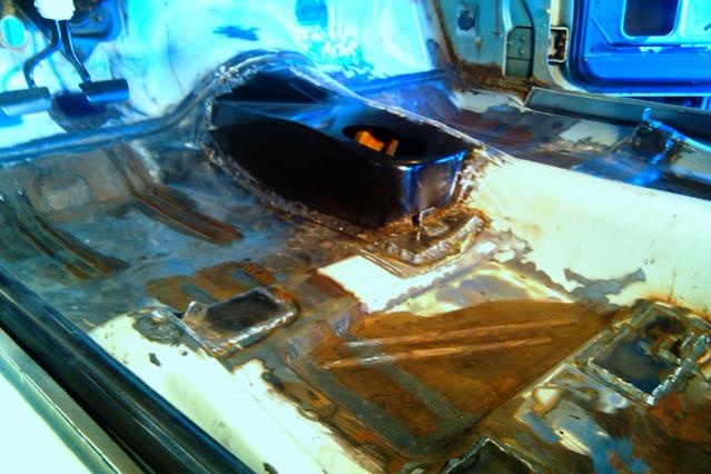

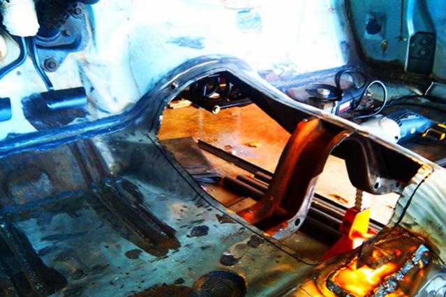

And for me to get the latest pictures posted. He cutout the tunnel for the new 4 speed tunnel &welded in the new one. Also welded in the reinforcement plates & mounting tabs for the new seats.
