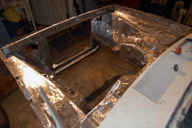

Nice work, what have you been using to get all that paint and rust off?
We used the old wire wheel on a drill first. That really took off all the loose flakey stuff and all the rust and gunk in the cracks and crevices. Then we switched to a Poly-Carbide Abrasive Circular Brush (Black cord with abrasive pressed into a wheel shape). That took the fine stuff off real nice. Took a lot of patience and elbow grease.

Primered engine compartment
Painted frame rails and inner fenders
Installed Control Freak K-member
Wheels and tires mounted
some seam sealing

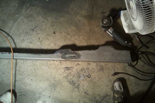

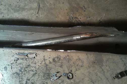

Subframe connectors ground to fit and E-brake cable tube installed
My plan for this weekend is to weld in the subframe connectors, torque boxes, and brackets for the four link then finish the front suspension. Brakes and rear end is on order and should be here any day now.

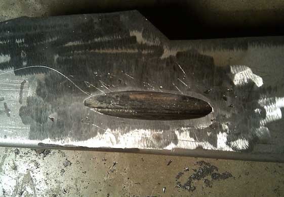

A few pics I've not seen, looks good son. :thumleft: I like the way you did the the tube thru the sub frame for the e-brake cable. :thumleft: :thumleft:
Thanks Dad.:lol:
Thanks 3404Speed.:lol:
I was trying for something cool and different, but wanted it to look factory. More functional than just slots also.
