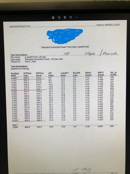

almost the exact same as a 400hp 318...
moar cam, moar rpm, moar carb... hmmm...
That's what bugs me the most, when the naysayers act a 318 won't respond to basic hot rodding, if the bore is smaller than 4" normal physics stops apparently :)
No it's the 318 cast on the side of the block - black magic fuckery that stops it responding to modifications like any other engine. 1HP/CI is relatively easy to build, a 400hp 318 is 1.25hp/ci - a little trickier but still within reach of most guys with a bit of knowledge.
