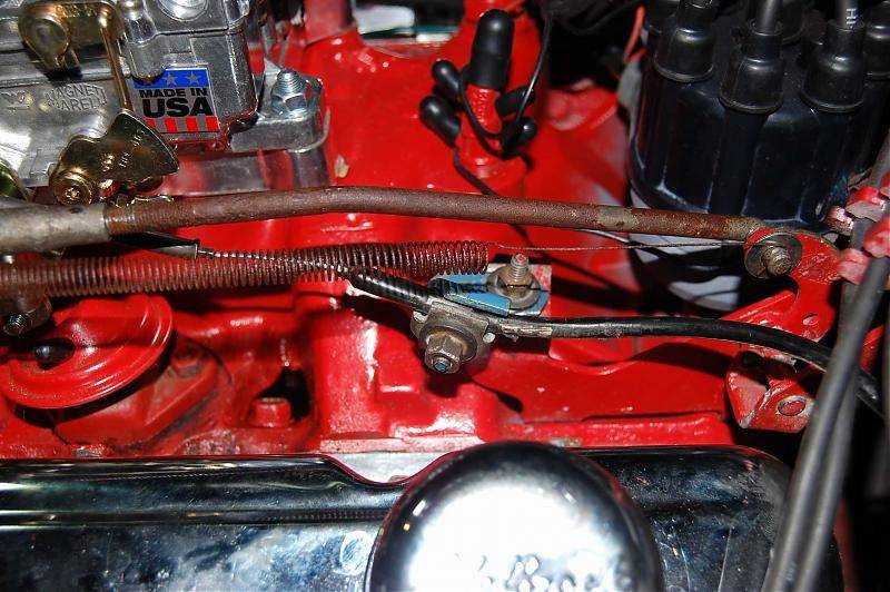

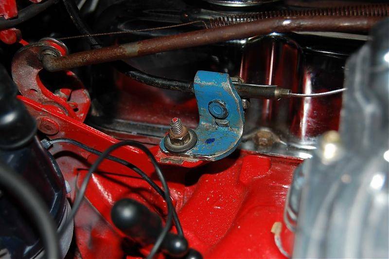

Here is a pic of what I am suggesting.
Hey JohnnyDart, That kickdownrod you have with the center mounted spring is still a mystery to me. I looked at @ 50 mopars in junk yard the other day and never saw one! Do you have a sorce for those?
You have a great set up there. You stated the Edlebrock to Chrysler carb adaptor $10.00? Is that the black Isolator under yours? If it is, does it have the 4 holes or 1? Where can you get them for $10? Edlebrocks plate was $43.00 + tax in our area. I did find one that had 2 carbon inserts 1 with 4 holes recomended and 1 with open bore for $25.00.

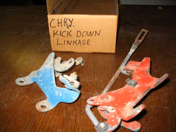

Pic of my unemployed junk yard solution. (cut extra braket, drilled and bolted on, still not exactly right) I would love to upgrade to your nice set up on linkage!
Please advise on source of nice parts!

Chrysler throttle lever adapter: Part# EDE 1481......Summit Racing, or anywhere.
Got the carb kickdown rod at a junkyard. Just about any Chrysler with a auto and 4 bbl will have it.
As long as it is a small block bracket.
Do the holes that bolt up to the intake match the holes on the blue bracket ? If so your in....
